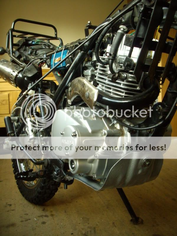

engine out
https://i31.photobucket.com/albums/c357/satelliteone/Sukida%20GY125/IMGP4302.jpg
https://i31.photobucket.com/albums/c357/satelliteone/Sukida%20GY125/IMGP4297.jpg
porting awaaaaaay
reprofiled the valves, ported the inlet and exhaust ports. and matching the manifolds.

ports are now wider.
engine back in one peice

head all finished

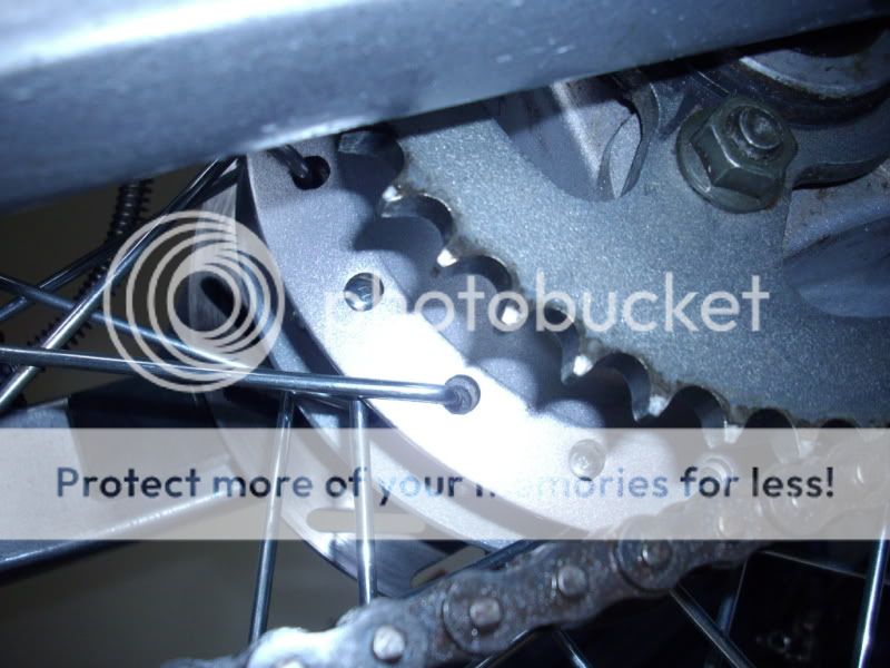

187 Miles?
How the FUCK does a sproket get teeth THAT sharp in so few miles!?!?!
https://i31.photobucket.com/albums/c357/satelliteone/Sukida%20GY125/IMGP4311.jpg

Teeth! on a cog and the restricted Cdi on a chinki bike.
Teeth looks fine to me !.. do you want me to take a better foto?.

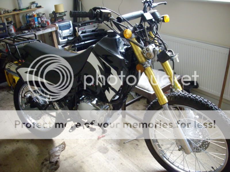

almost fnished, renewed the engine oil to day, next is the fresh DOT4 in the brakes.
https://i31.photobucket.com/albums/c357/satelliteone/Sukida%20GY125/IMGP4376-1.jpg
awating another set of forks. These are pitted.. Grrrr.. Chinky metal
and the sproket looks great to me..

i think youve put the forks in the wrong way round.
the brake caliper should be between the forks and frame, not on the front.

only done 182 miles from new
In 182 miles, the forks are pitted badly enough to warrant a new set. Shocked Impressive.
Looking forward to seeing the results. Pretty cool project Thumbs Up.
satelliteone
Joined: 08 Feb 2007
PostPosted: 11:18 - 05 Oct 2010    Post subject: Reply with quote
We have some eagle eyed viewers in the house!.
The forks are pitted, and mr postie is on the way to give me some really good second hand ones, The Ebay parts department sorted that out.
Agreed. iam not sure why they are either carvel. It looks like. some one has damaged them in the first place. The history of the bike, was left in a back garden with loads of small children for quite a while. The marks are pretty uniform horizontal. makes me wonder. Hitting with a stick or somthin. then just left to rust. OR just could be crap metal! But 50 quid to replace!.not too bad.
Yup and they are on the wrong way round too. Also the bottom yoke bolts aint done up yet. It was just temp way of getting the front end sittin proper, while i put the engine back in.
Dont worry, It will be righted..!
Comon mr Postie!.. i want to ride the beast..

its finished!.. all i need now is a can of petrol. Wheel it out side. and see if it fires up..

OK, sproket looked rather pointed in first pic.... butr hey-ho... nice to know that they have out-lived the fork-chrome Shocked
