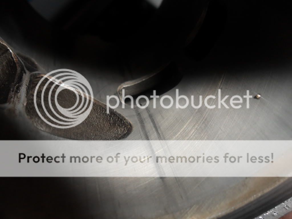

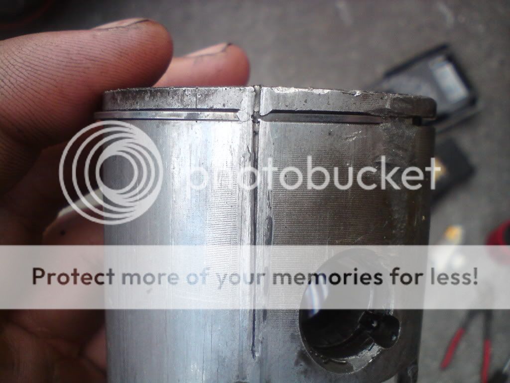

I've managed to snap my piston ring thanks to bits of metal....
Basically I was going uphill on my 70cc scooter at about 60mph and the gudgeon pin decided to get sharp, shred the gudgeon pin and spit bits of metal all around my crank and up my ports into the head/piston: https://i1222.photobucket.com/albums/dd482/Ben_Piranha_Lewis/DSC01911.jpg
Not the best moment of my life, seeing as I was on the isle of wight scooter rally.. lol
Luckily there is only very minimal damage to the barrel :
https://i1222.photobucket.com/albums/dd482/Ben_Piranha_Lewis/SAM_0175.jpg
Any ideas/ suggestions on removing the nick?
Just, carefully, get a bremmel drill on there?
Can't really port it out anymore as it's already massively ported, it's the "Stage 6 Racing 70cc" kit.

You may also have to consider splitting the engine cases to make sure nothing has been left inside, last thing you want to do is rebuild the top end and then have some poxy piece of metal screw everything up again.

Already done that, rinsed it with loads of petrol and 2 stroke, all clean. Smile

There could be piston slap, we don't know how bad the barrel is.
Looking at the piston the barrel is well cooked.
Source: Built loads of top ends.
Yet you can buy them for £90 on pedparts.co.uk lol
What's that got to do with my reply on re-jetting?
Two stroke barrels wear down the exhaust port side so place the pistion in and check for piston slap before deciding weather or not you will get away with a re-hone and an oversized piston kit.
You don't fit an oversize piston from honing a barrel either. Honing doesn't guarantee the bore is round unless you happen to have a sunnen in your pocket.

Anyhow, it's fixed and running like a dream again now, got a mate to carefully port it a little and the nick is gone now, the excess coking on the head is due to me not pre-mixing at the right ratio and having too much oil in there, so it's making a mess.
These Stage 6 kits are notorious for needing a new piston ever 3000 miles or so. oh well. Smile

It's all good and well so far, went in for a quick dyno run at my mates shop, kicking out a lovely 10.4bhp, run on a moped dyno not a full bike dyno so it's much more accurate, all factors like air pressure and temperate and sea level elevation taken in. Very Happy
He had a look at the piston and the barrel and said no issues, but the kit is designed for sprinting rather than long distance riding really. Smile
Sold: NRG 50cc, SR125cc, CBR125cc, Mito MK 1 125cc, Speedfight 50cc, Stomp 125cc, cbr125cc, NRG 172cc, CBF 125cc, Zip 70cc, stomp 140cc
Current: CB500 (waiting on DAS)
Pete.
PostPosted: 12:28 - 05 Sep 2011    Post subject: Reply with quote
benandthenrg wrote:
..but the kit is designed for sprinting rather than long distance riding really. Smile
Roughly translated - it has cooling issues!
