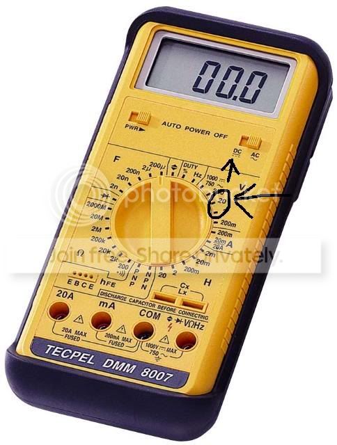

Anything that says DC with numbers? you'll want to set it to the lowest number you can that is above 12. On mine it is 20.

Edit, from memory, although it was quite some time ago, it looked liek this one..
https://www.tecpel.com/Multimeters/Dmm_80072.JPG
I'm guessing top right quarter "V" and set to 20? Providing it's the same and has not other values between 12 & 20, also set to DC, if it has that option that is.

You want to set it to this:
https://i1098.photobucket.com/albums/g378/swmpy50/Dmm_80072.jpg
Looking for over 12v at rest, should be 14.5v ish when bike running.
