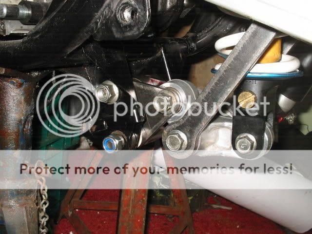

knowing that english people (sorry) are not very often precise on the year of their bikes , look serial number . if it begins by HI-xxxx year is 1989-1992 and by ZDCJC22 it's 1993-2001 (foxeye)
faired or unfaired doesnt change anything but the 2 models cannot be exchange
here is a pict of a foxeye , you can see the adjustable spring compression

it's a 1997 foxeye model. on the website it says the part is for 92-93, does this mean it won't fit then?

look or not look isnt the question , read what i wrote : the 2 models are not exchangeable !

to be sure only the length (between the fixing axis) which the point , because JC20 use 17" wheels and JC22 use 18"
