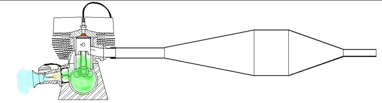

Being a 2 stroke you'd be just as worried about the fuel flowing FROM the crankcase past the piston rings INTO the combustion chamber, as fuel is first drawn into the crankcase on most 2 strokes. (And thus 2 stroke oil is added to the fuel to lubricate the crank case.)
c_dug
PostPosted: 11:33 - 06 Dec 2011    Post subject: Reply with quote
Confused I really am confused then, I'll take this opportunity to STFU and stop offering advice Laughing
PostPosted: 11:42 - 06 Dec 2011    Post subject: Reply with quote
https://2.bp.blogspot.com/_gAgQvbXCkxQ/TSOvje5ZKnI/AAAAAAAAACw/cKFpF0H_mWI/s1600/2+stroke.gif
The crank case area is used to pressurise the fuel/air mixture and force it into the combustion chamber.
