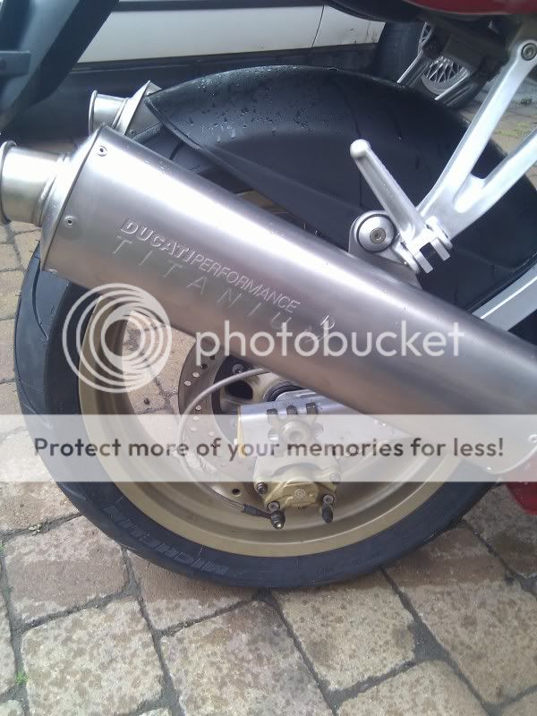

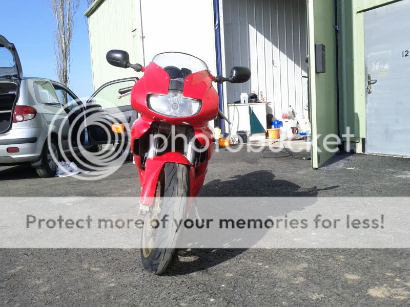

https://i34.photobucket.com/albums/d112/pitslayer/Duke/IMG_20120311_140844.jpg
https://i34.photobucket.com/albums/d112/pitslayer/Duke/IMG_20120311_140828.jpg
https://i34.photobucket.com/albums/d112/pitslayer/Duke/IMG_20120311_140835.jpg
https://i34.photobucket.com/albums/d112/pitslayer/Duke/IMG_20110628_193422.jpg
What do you intend doing to it?

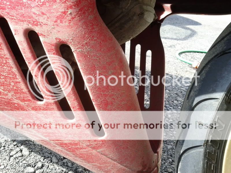

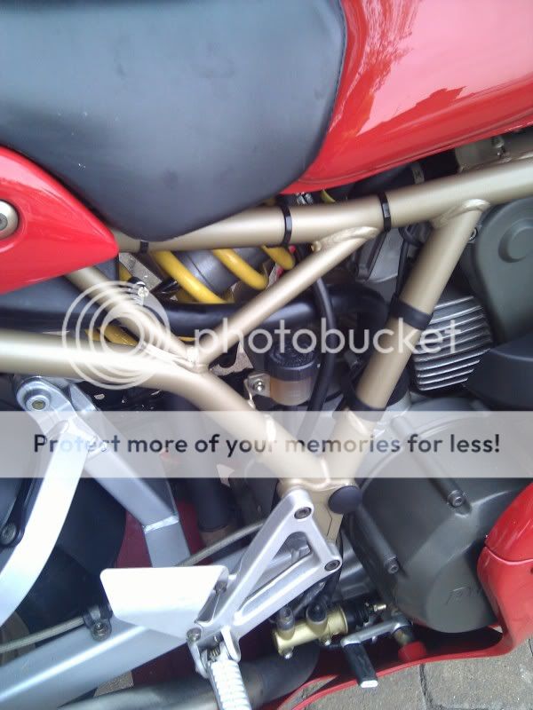

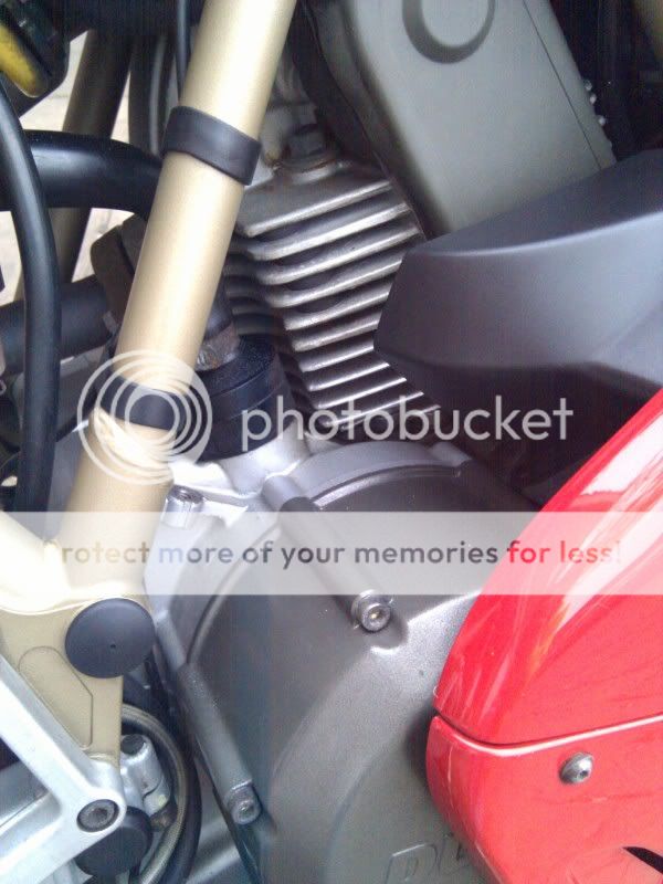

With it up on the stand you can really get in and clean it, only pics I really have
https://i34.photobucket.com/albums/d112/pitslayer/Duke/IMG_20110429_093325.jpg
https://i34.photobucket.com/albums/d112/pitslayer/Duke/IMG_20110429_093128.jpg
https://i34.photobucket.com/albums/d112/pitslayer/Duke/IMG_20110429_093149.jpg
I personally like to get the fairings off, and use a soft brush and an some water based engine degreaser to clean all the engine etc up, you have the advantage and disadvantage of not having the lower fairings, they are bugger to keep clean internally, but at the same time they show up any leaks you may get

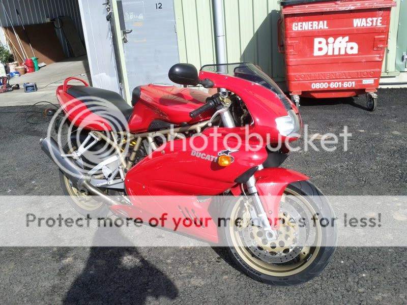

That said, she does get used
https://i34.photobucket.com/albums/d112/pitslayer/Duke/IMG_20120311_131527.jpg
