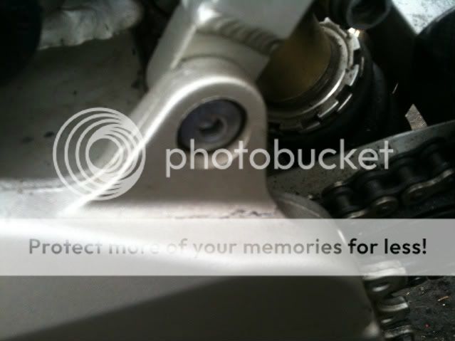

PostPosted: 17:11 - 18 Jan 2012    Post subject: Reply with quote
Update:
It is a 1999 ZX6R
Been in contact with the guy and he is looking for £450 for it.
https://i94.photobucket.com/albums/l100/Photobucket_Gazz/photo3-1.jpg
Thats the crack.
Also needs all fairings, grabrail, indicator, levers to name a few parts.

PostPosted: 17:24 - 18 Jan 2012    Post subject: Reply with quote
As far as i can see on my phone it's only the subframe mount? I'd just get that welded and keep an eye on it.
ZXR750L
PostPosted: 17:26 - 18 Jan 2012    Post subject: Reply with quote
That should be easily weldable, but would also expect the result to be fairly obvious and put people off buying it in future. If for a track bike or something to run into the ground then possible.
I rebuilt a ZX6R with the owner a few years ago, also due to a cracked frame (below the peg hangers). It is a fair amount of work. Also watch out for minor changes in the frame over the years (ie, on the ZX6R the engine mounts half way down the frame changed design - not a problem except for the delay waiting for the new mounting bolt to be delivered).
HD
Joined: 16 Dec 2009
PostPosted: 19:58 - 18 Jan 2012    Post subject: Reply with quote
Or weld both sides so it matches?
MaybeGuy
Joined: 12 Mar 2007
PostPosted: 20:19 - 18 Jan 2012    Post subject: Reply with quote
If it's not registered as a write off, I'd buy that in a second. Repair would be a piece of piss. If it's a cat B though, new frame time.
If you don't want it, and it's HPI clear, PM me the deetz.
