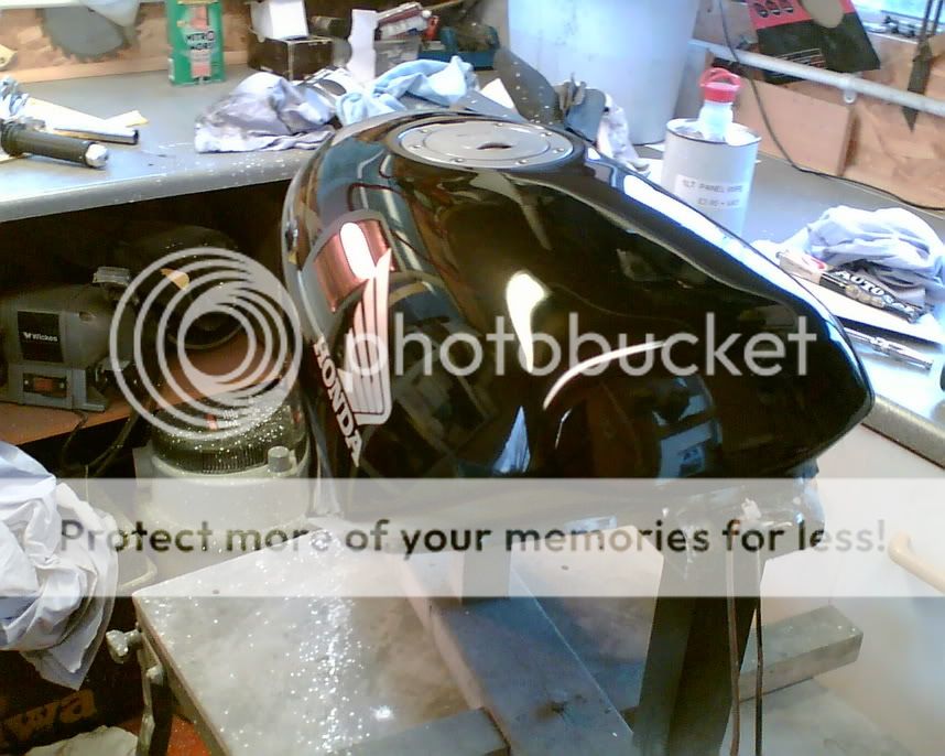

If your attitude is you cant be arsed to spend a bit of time doing a proper job on your tank, then how well is the rest of the bike looked after?
Look what you can achieve with a little bit of effort!

Rncv wrote:
how did you achieve that finish? :O
The tank had a few dents so lots of prep sanding and then priming, more filling then final prime coat. Wet flat with 1200 paper. Put the colour on in even coats. wet flat with 1200 paper then use a paste like G3 or finesse it with a mop on a polisher or drill. Then put the clear coat over the top and do the same. Just takes time and a bit of effort like doing most things right do!
How a tatty old bros I got my better half ended up!
https://i8.photobucket.com/albums/a12/robs321/fuel.jpg
