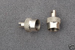

In that case, if the soapy water over the damage already mentioned doesn't produce bubbles of escaping air, try using a valve tool to remove the valve core, give it a clean and replace it. Pump the tyre back up, check the pressure after an hour and see if it still loses air.
Valve tools are either built into some metal valve caps or you can pick one up at Halfords for a few quid.
