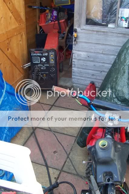

Right, just had a long hard look at my mig welder in the shed. It's a behemoth it really is. Managed to get it working again! Laughing just had a practise and It's alright. I need to grab some decent metal and have a proper go mind. Practise makes perfect and all that. Laughing

Euromig 200

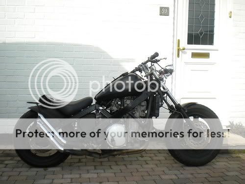

Right, I picked up a zzr 600 and I realised I really don't want a sportsbike. I want a complete custom machine. More on the ratbike side of things. Like this....
https://i82.photobucket.com/albums/j250/matttess/KGrHqJHJEUE914cuVzBPnwQbpj60_12.jpg
that was a cbr1000 at one point. Laughing
Right, so you know roughly what I want. I was thinking with the subframe, I probably won't be making it from scratch. I'll cut and reweld what's already there. No point making things really difficult, the way I see it the seat attaches to the subframe, so I'll cut the double seat in half to make a single, then use the bit of subframe and chop what I don't need then just weld it back on. Depending on how it goes I might not even need to weld major supports, just cut some off the rear and move the seat mounts. Thumbs Up
