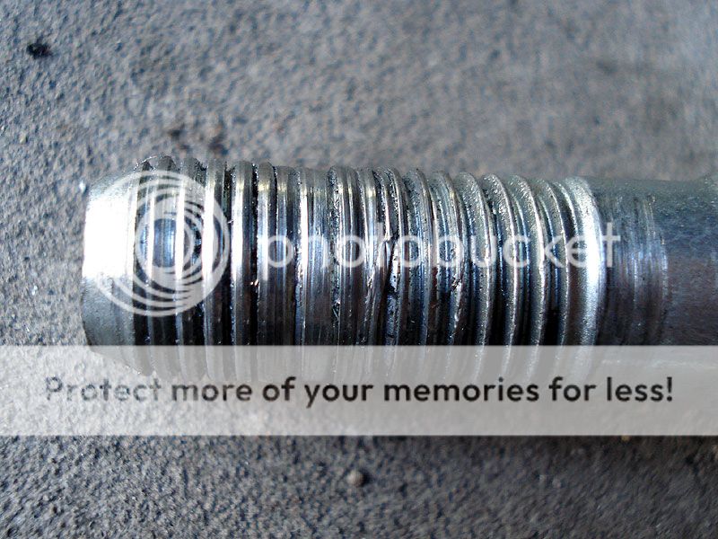

Decided to rebuild the engine my self, have been using you tube as my guide.
now I can't get off any clutch bolts, engine bolts, had to cut off two cylinder head bolts. getting fed up now. first what could cause all these bolts to get stuck? the engine was only rebuilt a year ago, did it overheat or something?
secondly anyone fancy trying to undo the bolts? I live in the new forest and would pay whatever as long as it's less than the extortionate mechanics. getting very fed up! Mad
oh I've tried literally everything even bought a blow torch today to heat the bolts up and still no luck

finally got round to trying out the plusgas and impact screwdriver as was ill last weekend, worked a treat.

What he said. Another way to do this is to tap the screw (not too hard) with a drill bit and hammer, if you cant make it any tighter.
When rebuilding a KE125 engine i found that a couple screws were kind of bent from the central point of the screw, probably because the holes in the engine cases were off a little, or maybe just vibrations from the enfine. This may be similar to what you're experiencing with those screws...
