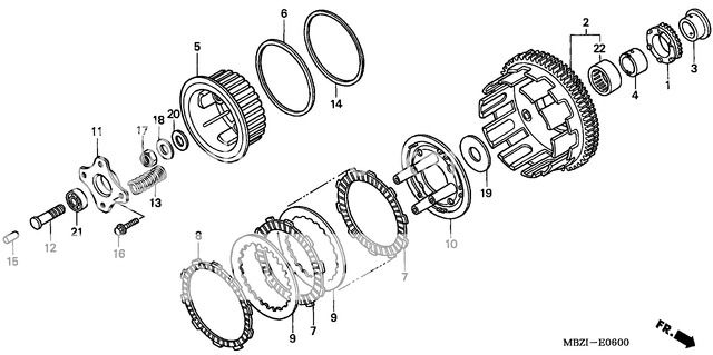

orac
Joined: 25 Sep 2011
PostPosted: 12:24 - 07 May 2012    Post subject: Reply with quote
well from that exploded picture its looking like you will either have make a tool, or just use the great box and brake/something throught the wheel method
