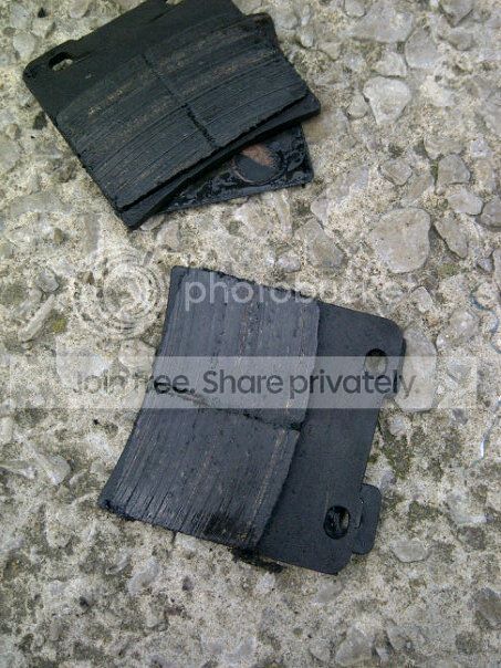

yambabe
PostPosted: 22:04 - 11 Jun 2012    Post subject: Reply with quote
https://i12.photobucket.com/albums/a229/Yambabe/pads.jpg
Thanks for all the advice everyone. Thumbs Up
Seals were fine, no fluid leaks, problem was caused by the above! Embarassed
New pads fitted yesterday, MOT duly passed today and much less chance of me rear-ending someone now......... Laughing
Pete.
PostPosted: 23:39 - 11 Jun 2012    Post subject: Reply with quote
Those pads were just about naked anyway, best thing you could have done was change them.
