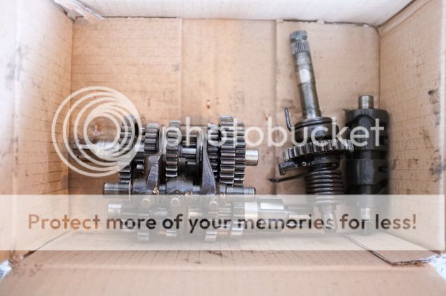

nfo
Joined: 18 Jun 2012
PostPosted: 20:02 - 12 Jul 2012    Post subject: Reply with quote
Isn't this just due to bike gearboxes having no synchromesh? If the dogs are meeting end-on with both the main and counter shafts stationary (i.e. the rear wheel isn't turning, the clutch has been disengaged long enough for the input shaft to come to a stop), then they'll never engage. You need some relative rotary motion between the sliding gear and the gear it locks to the shaft.
Here's a photo of some Honda gearbox innards:
https://i278.photobucket.com/albums/kk83/no_bb/CB125-SML/DSCF6871.jpg
(Exploded diagram here: https://images.cmsnl.com/img/partslists/honda-cb125s-s1-usa-transmission_bighu0213e4111_8d76.gif)
You can see that on the countershaft (which is at the top), the dogs on the third and fourth cogs from the left are meeting end on, whereas to engage successfully the dogs on one need to drop into the gaps in the other.
Correct me if I'm wrong, but with the bike stopped and engine running, if you start with the clutch engaged and the box in neutral, the mainshaft will be spinning. Pull the clutch in, engage first as it spins down and both shafts will now be stationary (you've connected the mainshaft to the stationary countershaft via 1st egear). If you're lucky, the dogs on second gear will be aligned correctly, and you'll be able to shift up, if not they'll clash.
If I'm right, rolling the bike back or forward a little should allow the dogs to engage. The honda gearbox has sliding gears, I'm more familiar with a sequential gearbox where the gears don't slide and there are separate dog-rings.
Hope that makes sense, I'm thinking on my feet.
