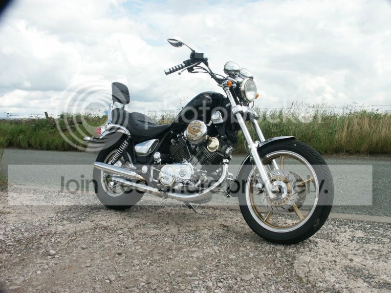

Just keep it clean. I don't use abrasive cleaners on chrome, just window cleaner.
This bike is 26 years old and was used pretty much daily. Virtually all of the major parts are original.
https://i93.photobucket.com/albums/l41/marki_03/xv1000/PICT1740c.jpg
The fork lowers were polished alloy without any coating, just wiped with ethanol to stop them corroding.
There are only three problems with corrosion on chromed parts that I am aware of on bikes. Abrasive cleaning removing the coating, rotting from the inside out and micro fractures. All of these can be significantly reduced with regular cleaning using the right stuff.
The best you can do to protect the chrome would be a clear plastic coating.
