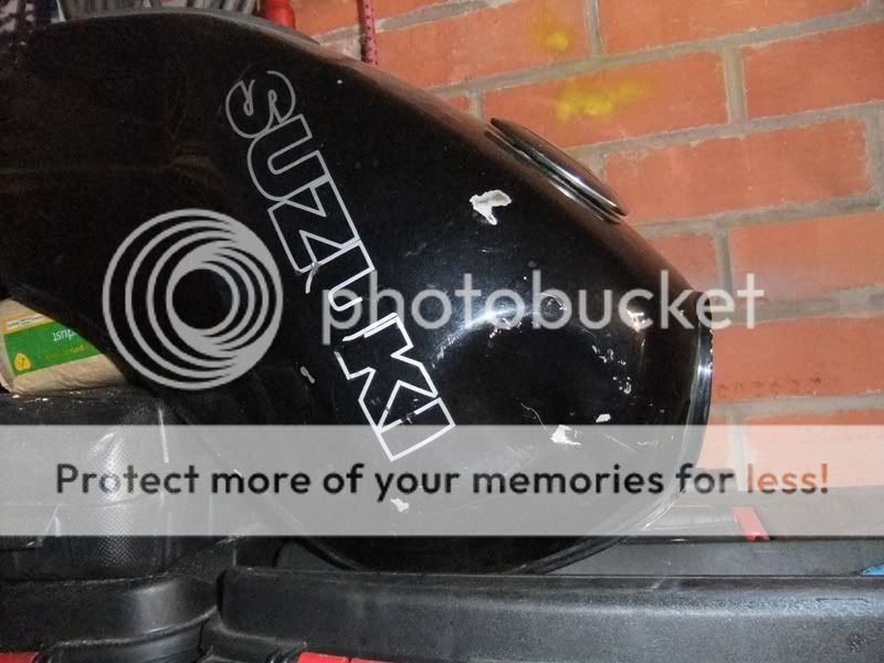

It is important to understand how deep / sharp the dent is.
If it is a half decent dent then it will need to be knocked out or pulled.
like this https://www.youtube.com/watch?v=tjOjYvT0jEU
Posting an idea that you read on the internet is retarded.
The thickness of a tank wall means the ideas that others have copied and pasted are unlikely to work.
Air pressure will deform the tank before it forces the dent out.
A sucker will not work.
Freezing? Just lol!

Water expands equally in all directions. How does the freezing differentiate(?) between a dent and a formed surface or a weak joint? How does it cope with stretching? Removing imperfections is different, I've completely removed small soft dents from panels simply by hitting a different part of the panel.
Please show me how this works because I would be really interested, it could save me a lot of time.
This is damage.
https://i93.photobucket.com/albums/l41/marki_03/GS125/oldtank.jpg

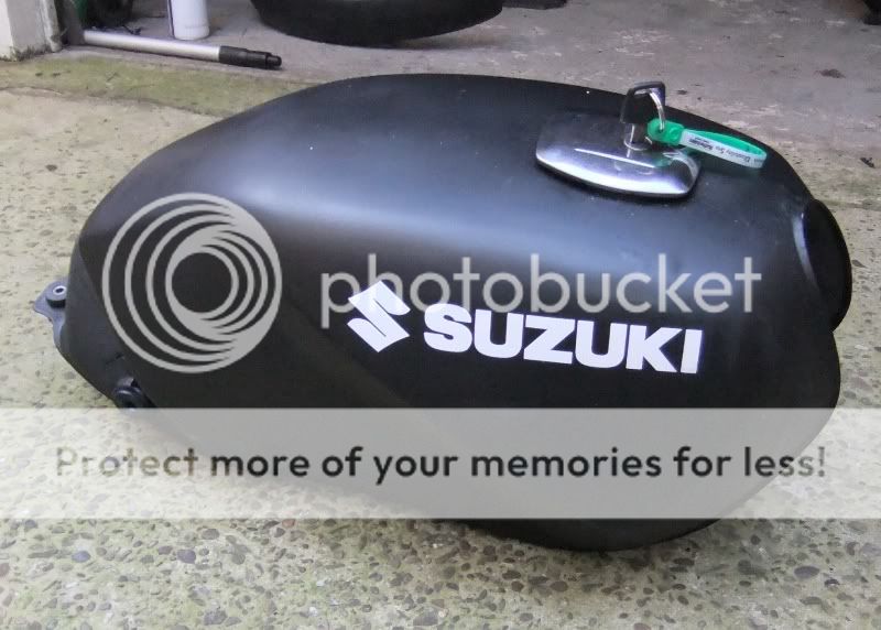

I'd already done it Laughing
https://i93.photobucket.com/albums/l41/marki_03/GS125/newtank.jpg
No air, no ice, no suckers, no filler just a couple of bars, hammers and a file.
