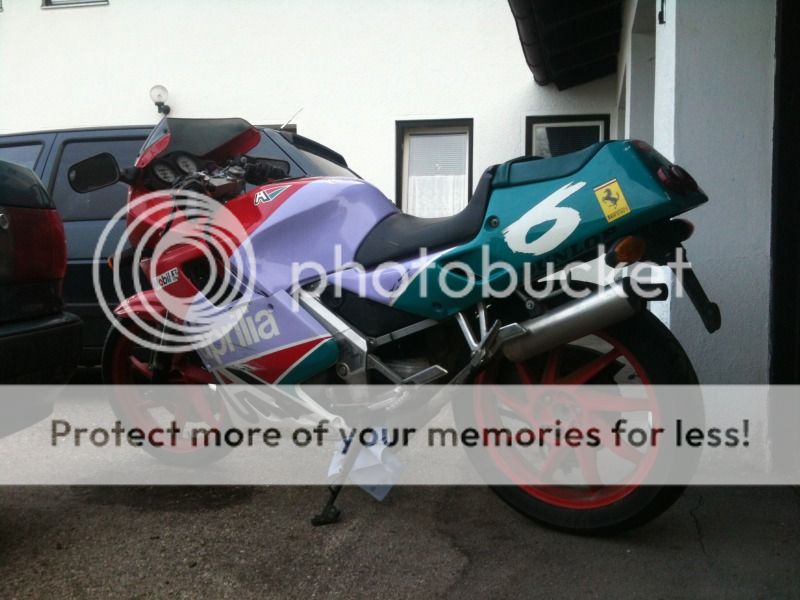

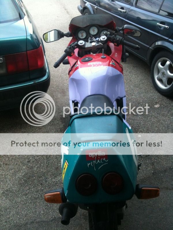

aprillia AF1 125 sintesi replica!
Going to be a slow one, as i have to sort out wedding plans before i can play!
got it for basically nothing, its been sit in my friends underground garage for a good few years, and he randomly mentioned it, and asked if i wanted to get it!
cant decide what to do first!
keith, can you share me some more information on her? - 1990 registered. 1989 model from what i can decipher on the logbook.
Lets see how much fun it is from all of my last bikes Wink Never had a small 2 stroker!

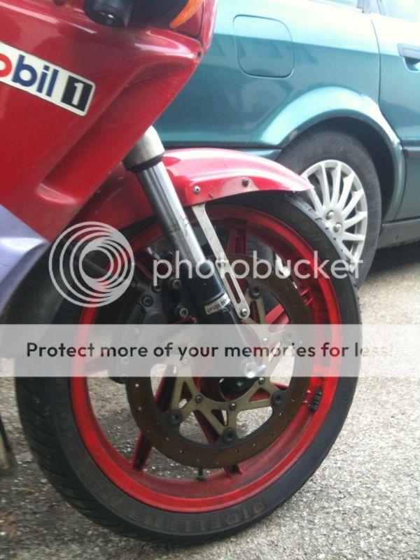

*small sticker on the fork says "upside down" - just incase we didnt notice i think!!*

Looks a beaut mate - can't wait to see the work on it Thumbs Up

Just clean it up... that looks absolutely awesome.
Get it cleaned and mechanically sorted, that will be a fantastic bike.

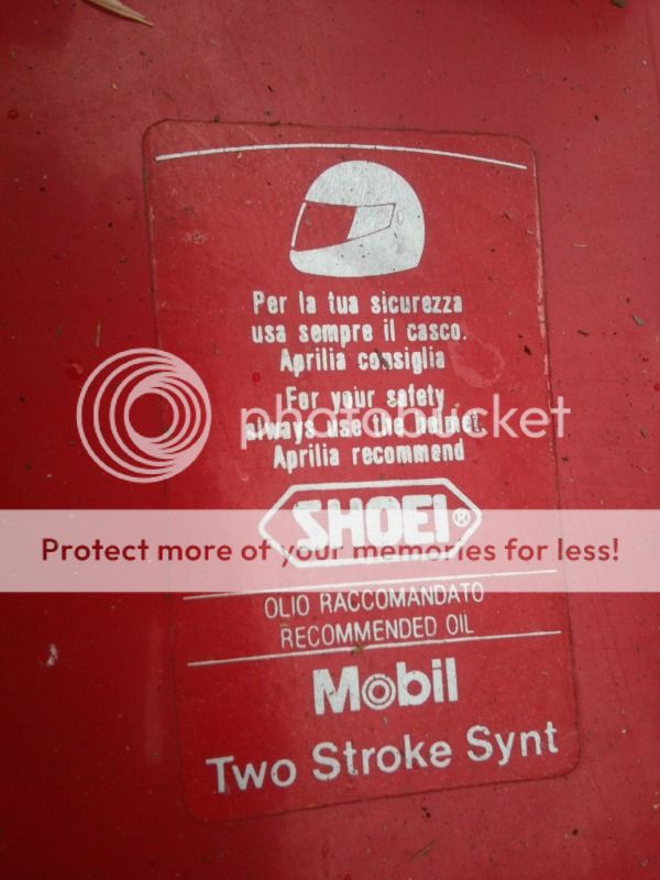

got lots of little niggley bits to replace. motor has a load of compression which is good. fork seals for definate. new coolant and fluids. tank wasnt too clever inside - ill get a pic of the old petrol Sad
just to clarify, this has been in a garage for 12 years unused Wink

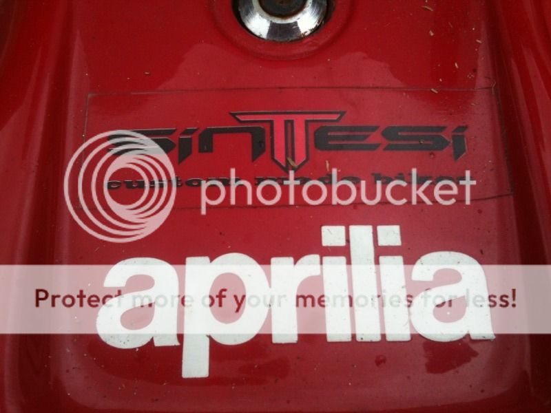

An early Sintesi. 1988 model one (quite likely registered in 1989).
The seat lock and petrol cap lock should have the same key. Note that there are a couple of different petrol caps which at a glance look VERY similar. If you can get the cap off you should be able to remove the lock from the cap to make it easy to get a key copied.

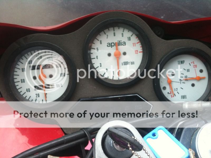

Good luck getting the fuel gauge to work if the tank is all clogged up.

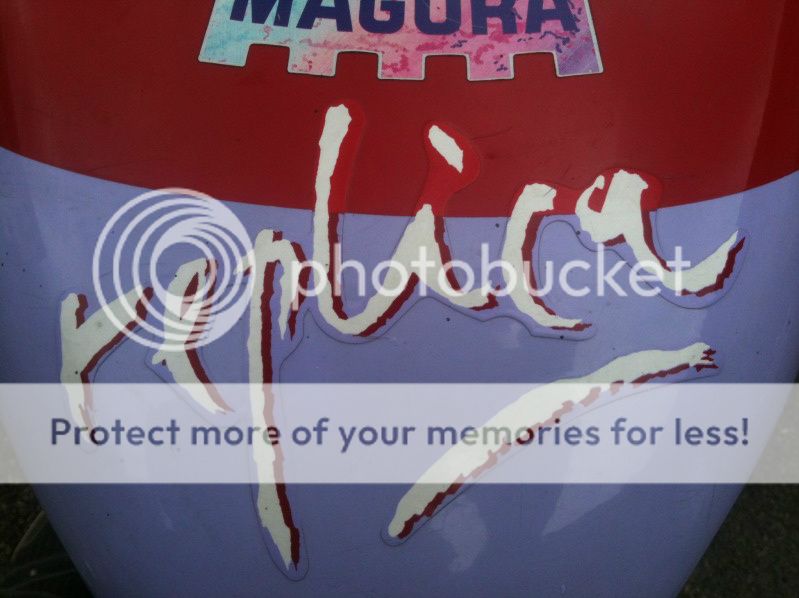

As a road test said, the stickers on the forks probably looked like that from people trying to peel them off and put them on the right way up. From memory they were the first road bike sold with USD forks.

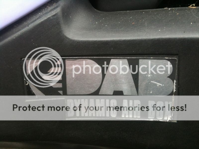

The dynamic airbox is just directing cool air at the intake to the real airbox. The air filter is oiled foam, but check it hasn't rotted away by now.
The tail lights quite often seem to break the small mount at the bottom.

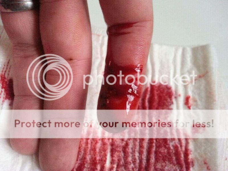

very happy! - apart from cutting my finger down to the bone on a knife trying to cut through the oil pipe. so spent a while at docs
Edit :: https://img.photobucket.com/albums/v461/ylldeath/th_running.jpg
pic of said finger around 30 mins after https://img.photobucket.com/albums/v461/ylldeath/IMG-20121026-WA0005.jpg
