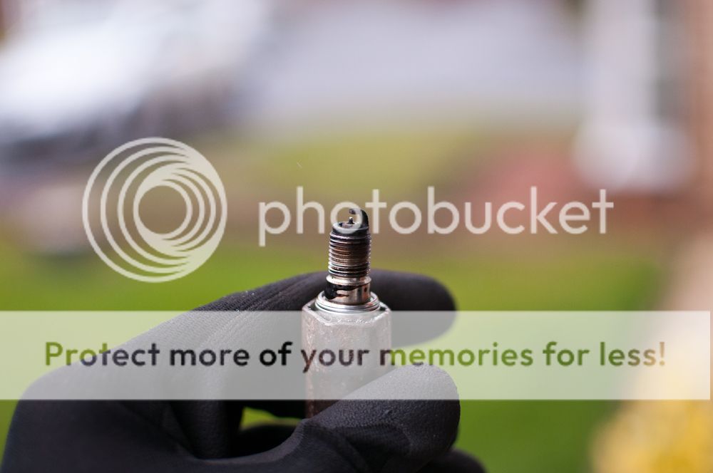

Also my plugs looked a little foul, they've only done a couple of thousand miles maximum, wondering what could cause that?

Judging by the crap on your plug,it looks like it may have been loose at some point.

I'll give them a wipe down and hopefully they will be ok.
