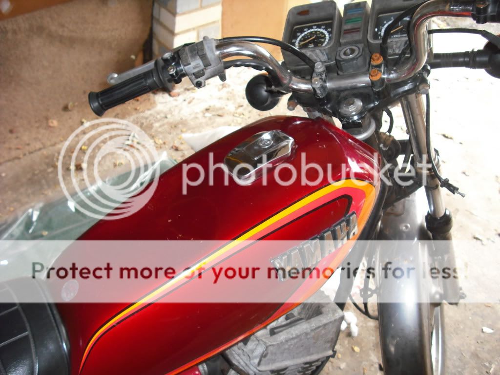

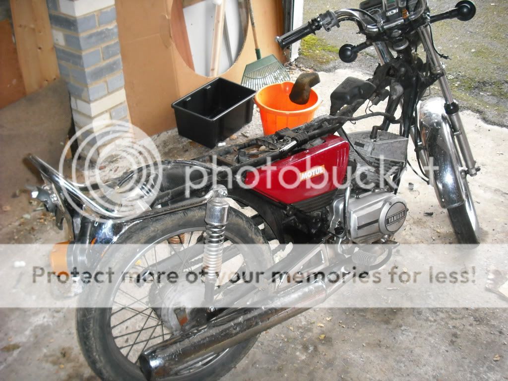

Right, bought the bike on Sunday from a nice local trader for only a few quid. He was honest and said it was in need of repair as it has been abused and unloved.
So enough tell, time for some show:
https://i1258.photobucket.com/albums/ii537/Stevey94/DSCF2738.jpg
https://i1258.photobucket.com/albums/ii537/Stevey94/DSCF2707.jpg
https://i1258.photobucket.com/albums/ii537/Stevey94/DSCF2718.jpg
How it looked when I got it home.
Plans are to strip down and clean, replace and rebuild into a working bike. Atm the engine is seized, forks are bent, bodywork is tatty, tank dented etc.

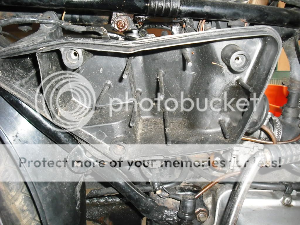

A couple of questions, under the right hand panel there is this black box...
https://i1258.photobucket.com/albums/ii537/Stevey94/DSCF2751.jpg
Feel like there is something missing?

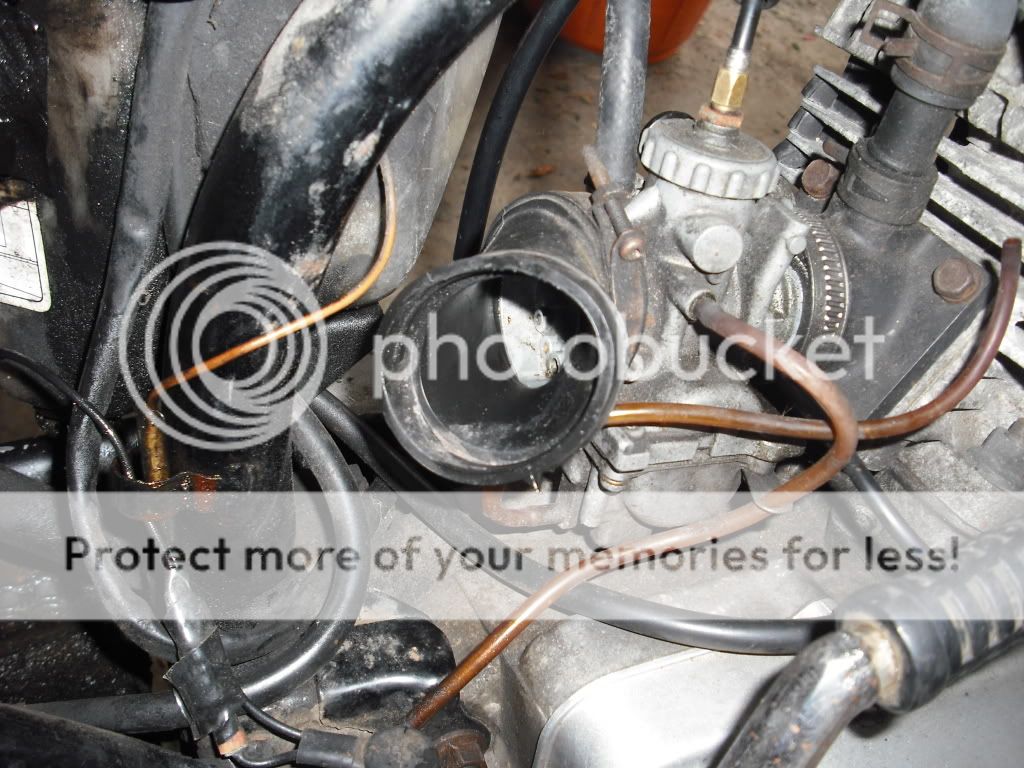

https://i1258.photobucket.com/albums/ii537/Stevey94/DSCF2755.jpg
Also here what does this black tube do? It runs into the carb so maybe an air intake/ box/ filter?

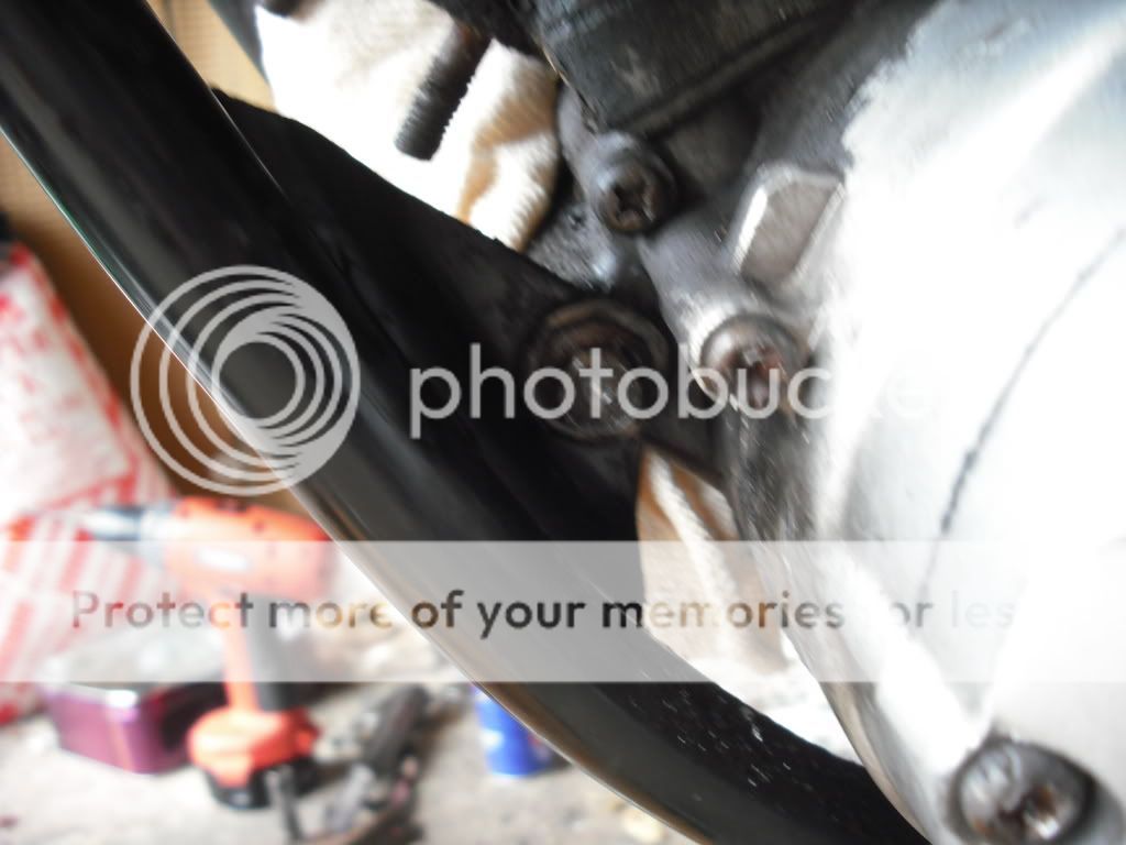

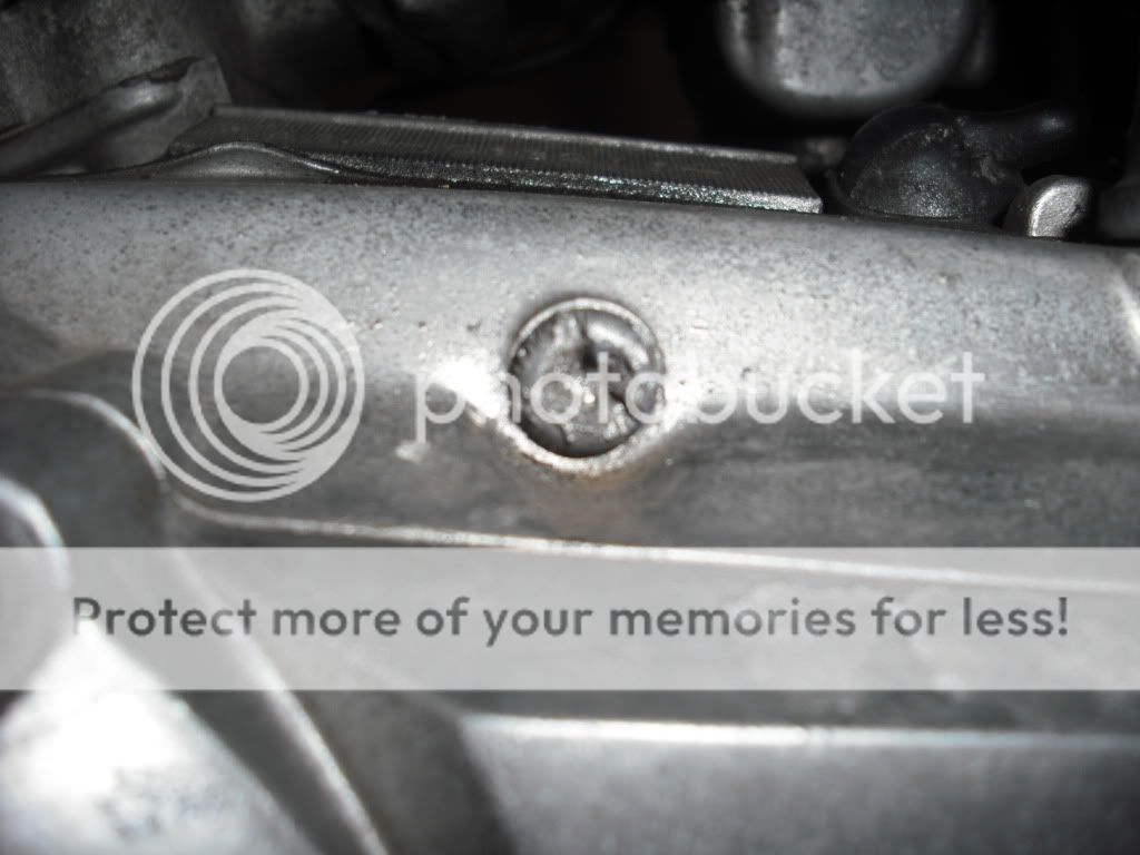

https://i1258.photobucket.com/albums/ii537/Stevey94/DSCF2732.jpg
https://i1258.photobucket.com/albums/ii537/Stevey94/DSCF2735.jpg

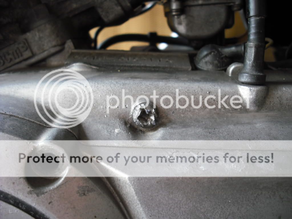

Many bolts are like this, what tool would you recommend please.
https://www.ebay.co.uk/itm/5-PIECE-PCE-DAMGED-SCREW-EXTRACTOR-CASE-BOLT-SCREW-STUD-REMOVER-EASY-OUT-/160832214896?pt=UK_Hand_Tools_Equipment&hash=item257258d770

I think the black box is to keep your sandwiches in Wink

These will cause you more trouble than they are worth, Buy an impact driver then if that fails chisel the head off and when you take the casing off use some mole grips.
Yambits is a great website and you will spend a fortune there.

Thank you for the replies. Bought an impact driver this morning and have undone a couple of the screw bolts.
Now I am having problems getting the hex bolts off. Tried using a variety of spanners and also sockets in my drill... They won't budge.
Any suggestions please, should I be using the impact driver for these as well?

6 sided sockets, and plus gas should get most of the bolts undone.
I also have a set of Metrinch spanners or nuts that have rounded corners.

Plus Gas and perseverance, if in doubt swear at it a bit Thumbs Up

Another way of getting out rounded screws it to tap the screw around with a center punch or similar. Just be careful not to slip and damage the casings.

Use an impact driver first, if that fails, the best way to deal with the rounded cross head screws is to carefully drill the head off, then use mole grips when the casing is off.
Much safer than trying to chisel or knock them round, too easy to clobber and damage the alloy casings.
Invest in some good quality sharp drills, and set the drill to the right speed.
Be wary of those easi-out extractors, they are usually made of very hard, but very brittle crap, so snap one off and you cant drill it out.

2 big mistakes people make when using drills:
1, Too much speed- the bigger the drill, the slower the speed, too fast and it won't cut and will overheat and become blunt very quickly, you can always use a drop of oil to help it cool.
2, Too much pressure -You need to keep a constant pressure on the drill, but don't force it, again it will overheat and blunt very quickly.
You'll soon learn how to get a feel for it, when you get a nice long strand of swarf ,it's cutting well.
Hope I'm not teaching you to suck eggs, just trying to save you buying bundles of drills like I did before I learned!!!

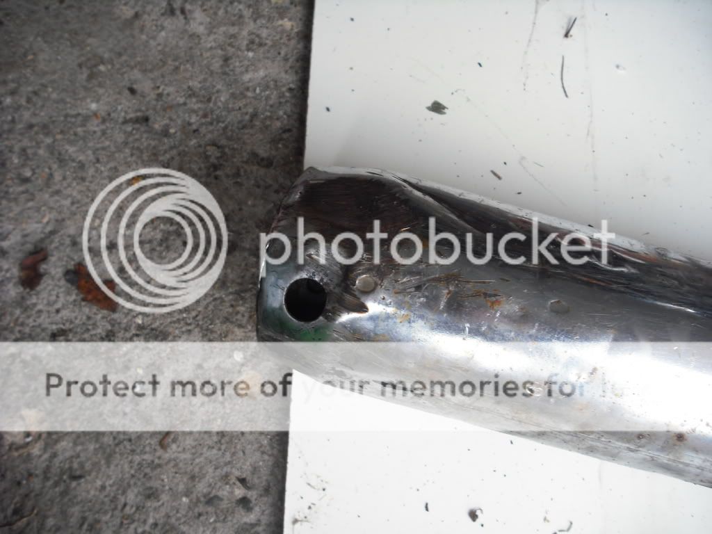

The Plus Gas worked very well and I was able to get the exhaust off.
https://i1258.photobucket.com/albums/ii537/Stevey94/DSCF2780.jpg
Original? or go faster hole?

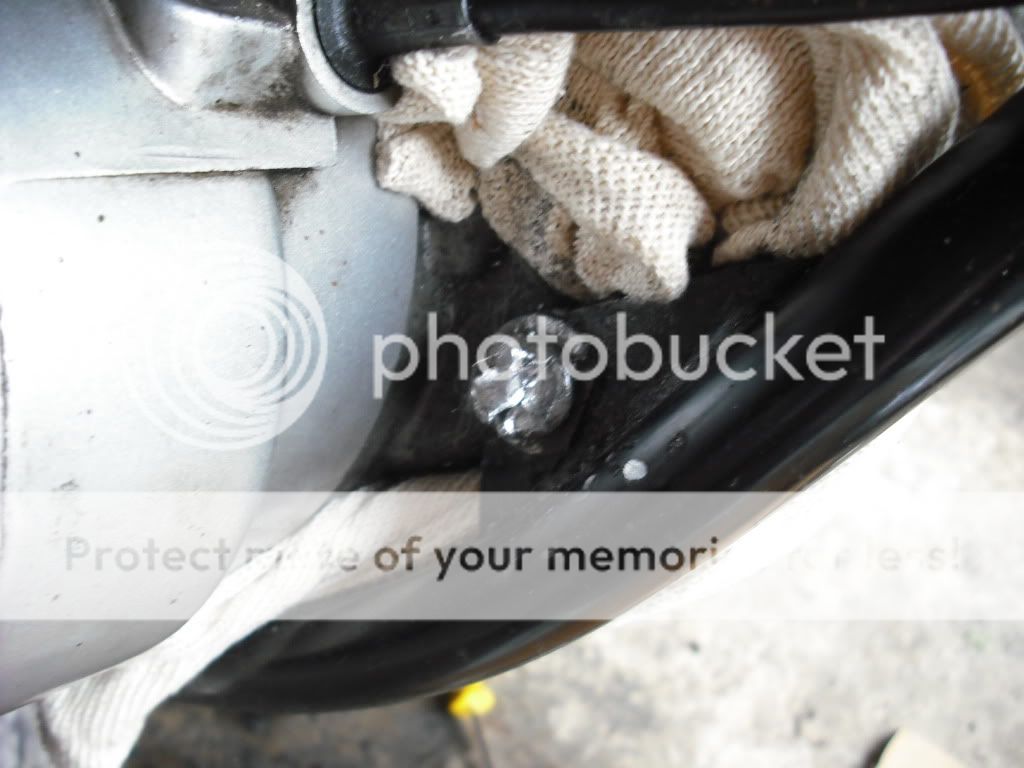

This main engine to frame bolt is being troublesome, any hints? Would it be worth buying a set of box spanners as I can not get it too shift at all.
The other end is shagged.
https://i1258.photobucket.com/albums/ii537/Stevey94/DSCF2781.jpg
https://i1258.photobucket.com/albums/ii537/Stevey94/DSCF2785.jpg

Hole in the exhaust is standard and normal. It's so you can take the baffle out for repacking. You should do this, as well as decoke it.
Looks like you're failing pretty hard so far though. Make sure you're using the right tools, and replace the screws with cap headed bolts.

The exhaust baffle - there's about six inches at the end of it which serve no purpose at all except to cause it to seize in the pipe. I always recommend cutting that bit off (the entirely hollow bit, before you get to the silencer disc bits).
The engine bolt needs a decent quality socket and ideally a breaker bar to get maximum leverage. If the nut has started to round off, will probably need to be broken using a nut splitter.
