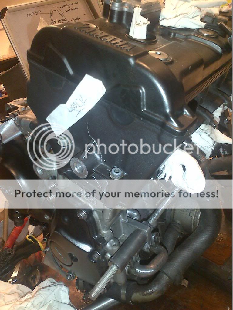

I bought a used R6 engine from a breakers back at the start of November. I've just got round to cleaning it up and getting it ready to go, and noticed during cleaning it there is a big crack in the head. It's on the part that covers where the cam chain runs around a mounting point and unfortunately runs all the way through the casing.
I'm no expert - but I wouldn't be particularly comfortable with running this head as the crack may propagate through with vibration & temperature and eventually cause something to come off inside the engine and then cause all sorts of crap inside the rest of the engine.
The engine came off a bike that (I imagine) had been written off by insurers, but there was no mention of the crack - guessing it just wasn't spotted. The engine was advertised as 'in excellent working condition as you would expect with such low mileage, and comes complete with the gearbox and all internal/external parts as shown', but I'm sure they shouldn't have sold it to me with a cracked head. Thing I'm worried about is that it's been 3 months since I bought it so outside of the warranty they specify, so they might not want to do anything about it. Admittedly I should've spotted it earlier but that's another matter.
So what are my options? Not a happy bunny today.
https://i1125.photobucket.com/albums/l598/gazzam1/Cambridge-20130201-00233_zpsade2acd3.jpg
https://i1125.photobucket.com/albums/l598/gazzam1/Cambridge-20130201-00231_zpsd64b2dc4.jpg

get it welded. drop the oil, make sure there is no circuit board on it. take it to a reputable engineering shop and ask them.
PostPosted: 20:46 - 01 Feb 2013    Post subject: Reply with quote
No wai. It won't work. That's right next to the camchain recess. any excess weld or warping in that area and the engine is toast.
The engine is toast anyway... Should have checked it out more thorougly. You can try complaining to the breaker but they'll just accuse you of damaging it in the mean time.

thought it was toast. on the original pictures of the engine you can see the crack if you know it's there so they definitely sold it to me like that!
We do have another head for the same engine but it needs a bit of work doing to it - the engine we had before (we being formula student team) swallowed a sintered intake that wasn't sealed proplerly, the material sintered itself to the valves and eventually it seized. That's been partially rebuilt, the cams need seating properly and the whole thing put together and shim'd but I really don't feel confident doing a big job like that!

On the original pictures of the engine you can see the crack if you know it's there so they definitely sold it to me like that!

I think you have got a fair argument. Point out that the crack around the lug is broken outwards, caused by the lug being pulled in the frame during a crash, rather than inwards as it you had been clumsy and dropped the engine on the side of the head.
Be prepared for them to claim that you have been using it in a bike and caused the damage by crashing yourself though.

You will not be able to get that piece welded.
They are very intricate castings with cavities and then machining for shafts etc.
So it's not possible to weld inside the cavities and if possible the welding process would stress the casting so it would probably fail later or miss align the machined parts.
You need another used head I'm afraid.
If the breaker has stock then he may take pity on you and try to help by discounting at the very least. The thing is you should have cleaned it up at the time of the sale as you only had limited warranty.
So I don't think it is unreasonable of the breaker to ask you to buy another rather than off you replacement for free. Sad
