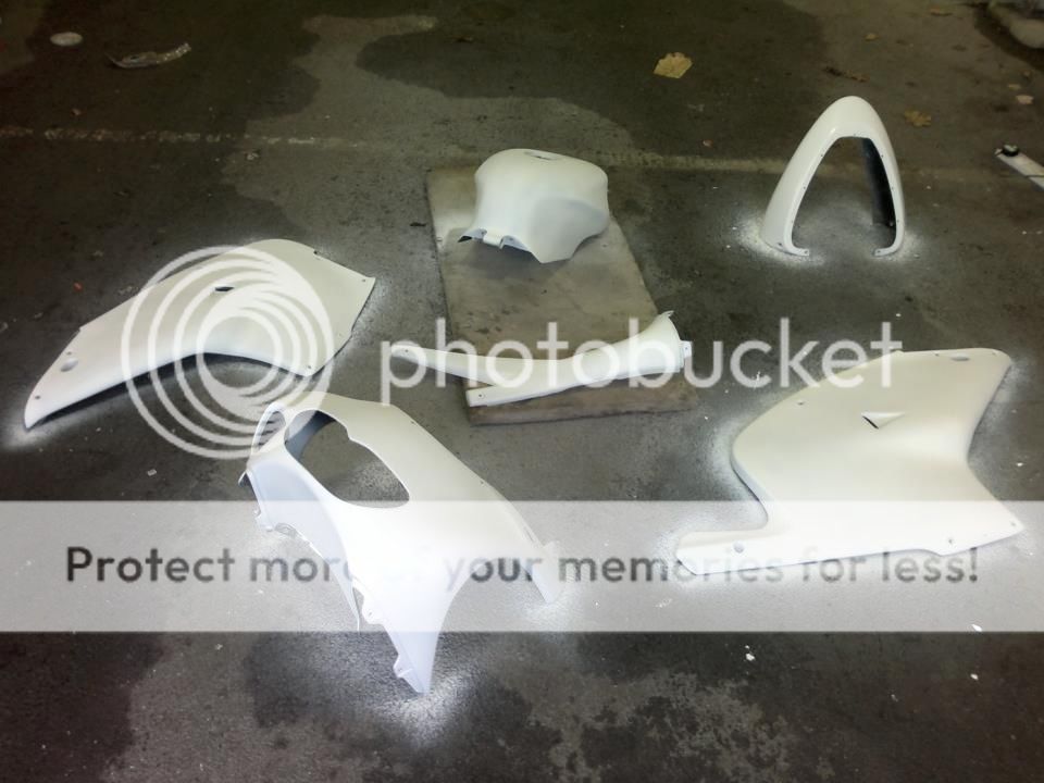

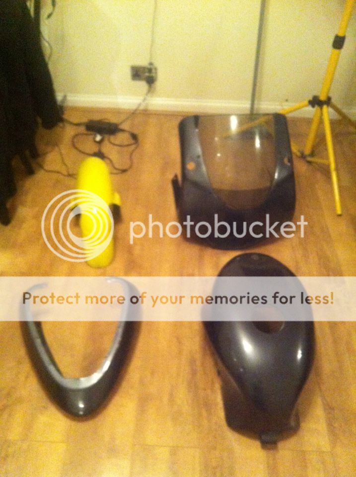

then i stripped it all to freshen it up
https://i18.photobucket.com/albums/b115/clarkie3985/Aprillia%20RS125/IMG_1561.jpg
https://i18.photobucket.com/albums/b115/clarkie3985/Aprillia%20RS125/IMG_1566.jpg
https://i18.photobucket.com/albums/b115/clarkie3985/Aprillia%20RS125/IMG_1564.jpg

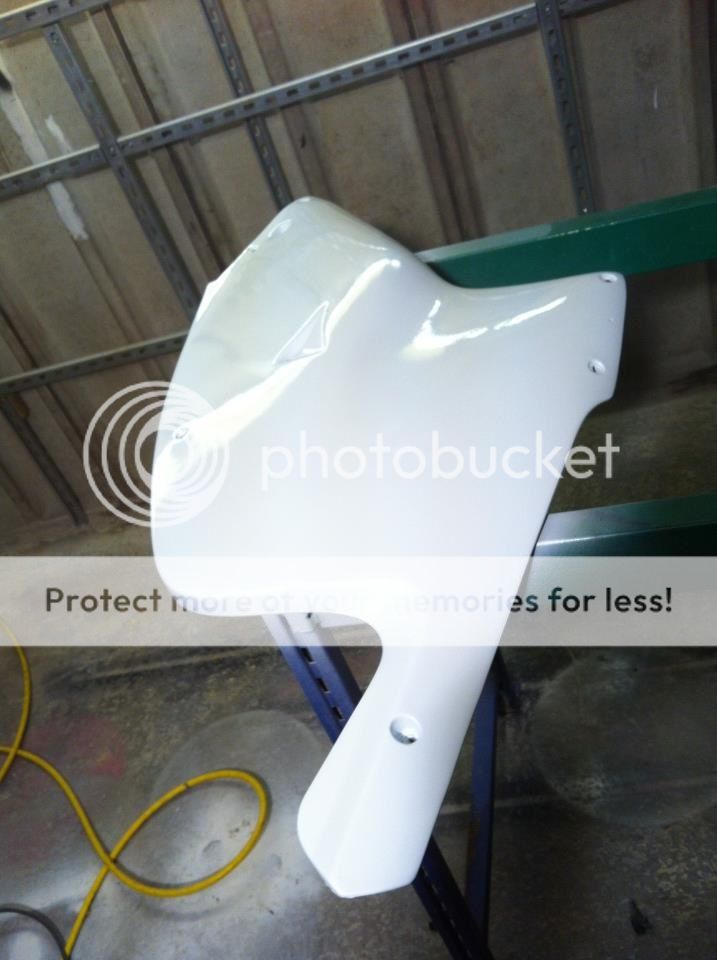

primered em all up
https://i18.photobucket.com/albums/b115/clarkie3985/Aprillia%20RS125/IMG_1565.jpg
https://i18.photobucket.com/albums/b115/clarkie3985/Aprillia%20RS125/IMG_1558.jpg
then final coats
https://i18.photobucket.com/albums/b115/clarkie3985/Aprillia%20RS125/IMG_1598.jpg
https://i18.photobucket.com/albums/b115/clarkie3985/Aprillia%20RS125/IMG_1582.jpg
https://i18.photobucket.com/albums/b115/clarkie3985/Aprillia%20RS125/IMG_1581.jpg
https://i18.photobucket.com/albums/b115/clarkie3985/Aprillia%20RS125/IMG_1576.jpg

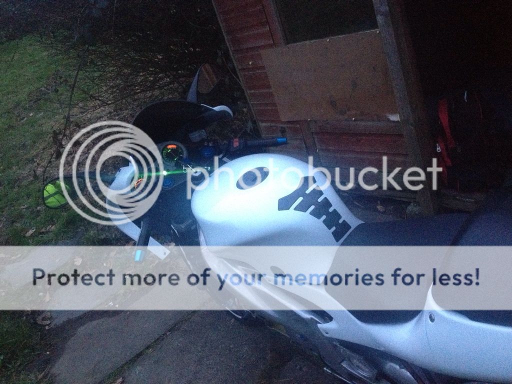

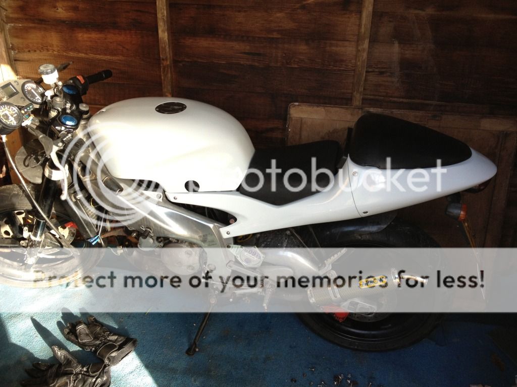

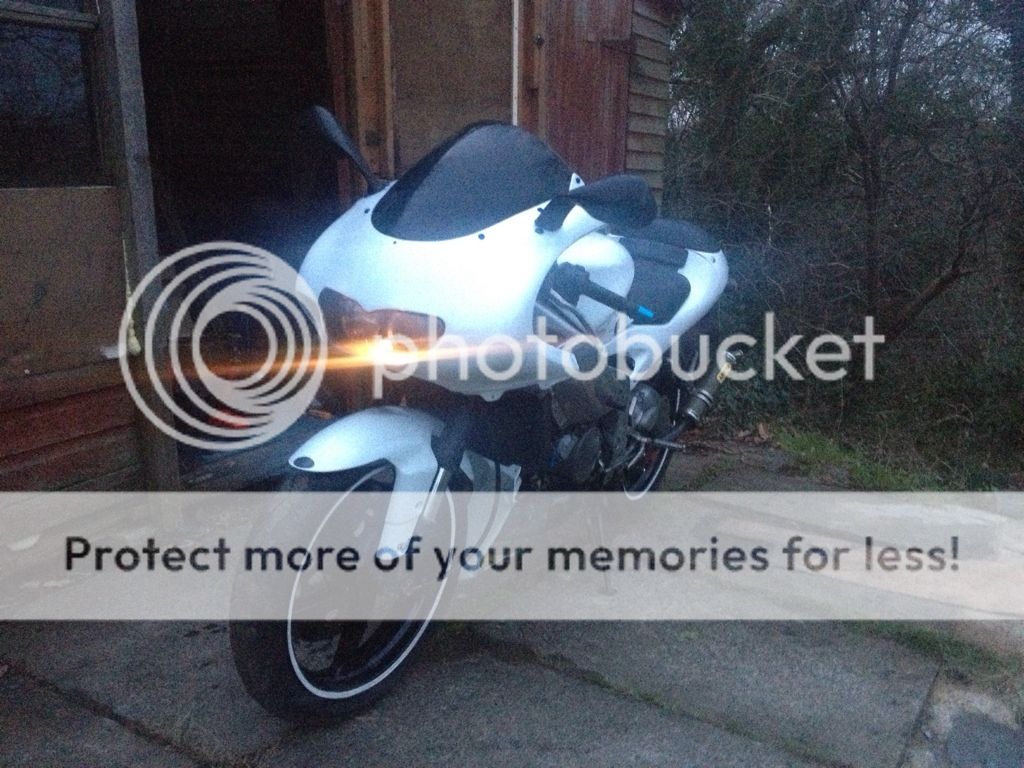

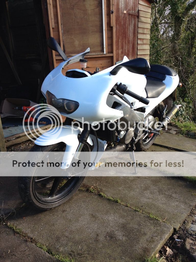

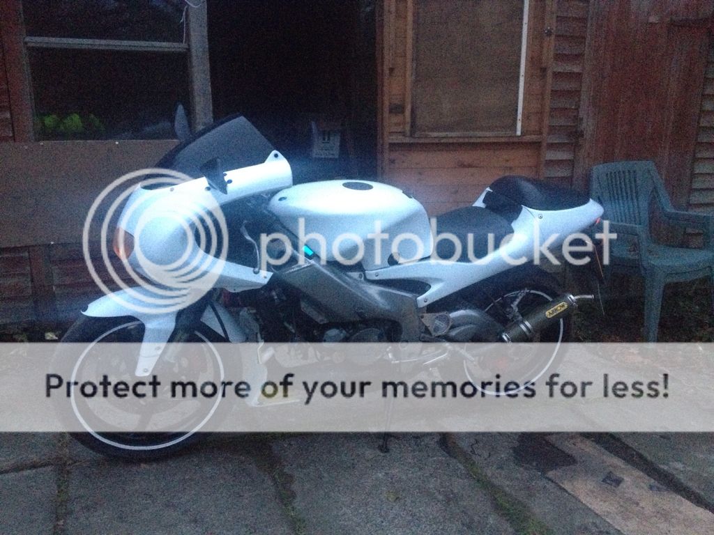

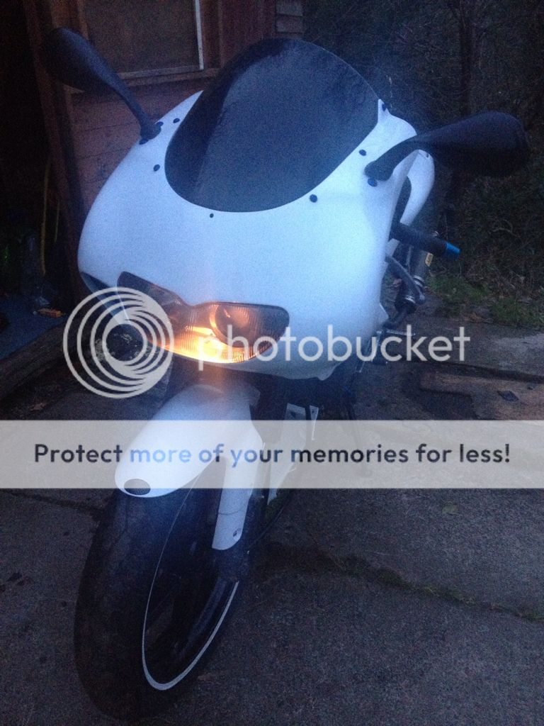

and putting it back together slowly
https://i18.photobucket.com/albums/b115/clarkie3985/Aprillia%20RS125/IMG_1610.jpg
https://i18.photobucket.com/albums/b115/clarkie3985/Aprillia%20RS125/IMG_1607.jpg
https://i18.photobucket.com/albums/b115/clarkie3985/Aprillia%20RS125/IMG_1611.jpg
still have not fitted front end yet, iv had to fit a uk headlight as light was projecting onto wrong side of the road, and i want to order some nice probolt fairing kit and screen bolts for it.
im also looking at getting these off ebay as a nice touch i think
https://i18.photobucket.com/albums/b115/clarkie3985/Aprillia%20RS125/IMG_1605.png
https://i18.photobucket.com/albums/b115/clarkie3985/Aprillia%20RS125/IMG_1606.png
so thats how she looks now id just like to get her running like she is meant to with the help of you guys and then ill be one happy chappy Smile she is only going out on bendy roads on nice days and the odd nice day to and from work so i dont use her everyday for commuting or anything Smile

Nice bike, subframes bent tho

subframe is bent? could you show me what its supposed to be like and where its bent?

replaced the clutch adjuster yesterday and the clutch... bought a couple of those ally replacement caps from pjme rather than putting the crappy plastic ones back in for the clutch adjuster cover and filler cap on gearbox casing.. also got some blue screen bolts and mirror bolts and tank bolt. new gasket and a new br9 spark plug and liquid top ups and im nearly ready to take her back out after the winter storage...
oh and i added some white rim stripes which i do really like how they look..
https://i18.photobucket.com/albums/b115/clarkie3985/F15F9C4E-65EF-4550-8FFE-3A7255C09FF6-486-00000114F92E6039_zps8971d339.jpg
https://i18.photobucket.com/albums/b115/clarkie3985/AB1BCDD9-8D8D-4710-B5B6-4BA659D876D5-486-00000115153B05D6_zpsf573fe2d.jpg
https://i18.photobucket.com/albums/b115/clarkie3985/BCAA0CCF-A677-42B9-BD84-2847D718875A-486-00000114C854BAD0_zpsa2a2dc59.jpg
https://i18.photobucket.com/albums/b115/clarkie3985/05FA28FD-E178-49E9-B409-2BFFB7EC0B62-486-00000114BBB1D1F3_zpsf5984c55.jpg
https://i18.photobucket.com/albums/b115/clarkie3985/1D996381-ADF3-42B9-8674-2195323B7670-486-00000114ECC20CF2_zps5ac05dab.jpg
https://i18.photobucket.com/albums/b115/clarkie3985/E39CF8C6-8AED-47A6-B804-437E23BE9959-486-00000114DF5A2F8B_zpsa4f89bb8.jpg

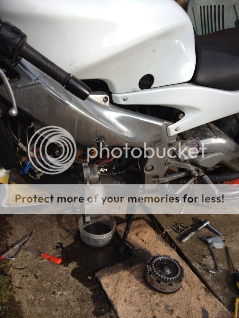

if you look close at the clutch assembly in this picture you can see the top plate isnt sat in the recess like it states it should do in the haynes manual..
is this fitted incorrectly by the previous owner or is there a reason it would have been fitted this way?
i have to be honest i stuck with the haynes factory settings and changed the setup so the top plate sat in the recess properly but it did work fine installed the other way. i wouldnt have known had i not took it apart. .
