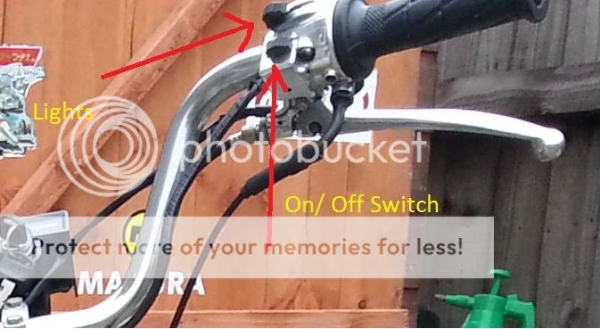

I am a tad confused Confused , what kill switch are you taking about? a 1984 model CG125 C-E does not have a kill switch, are you confusing the headlight switch with an engine kill switch.

on the right hand switch gear there is a switch for the lights (off, P & High) underneath of that is a switch thats says Off & On
i have a feeling my bike is a frankenbike to be honest - it has a BR-e engine but is B Reg 1984 which would make it Jap?
https://i25.photobucket.com/albums/c81/mudcow007/switch_zps2baee87f.jpg

My bro's has an electric start button there but has no electric start as it's as you say a franken-bike
Not known CGs to have killswitches
