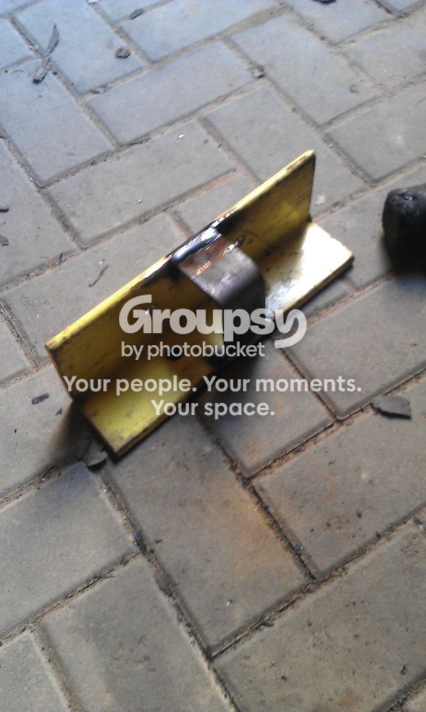

https://i435.photobucket.com/albums/qq79/connieboobie/IMAG1625.jpg
2 bits of solid.metal from work I.just chopped them up and got it welded seemed cheaper and stronger than other ground anchors as its on block paving AMD bricks
I could cut through that in about a minute with a normal hacksaw. Or one good hard smack with a hammer to break the welds.
I once made a bolt-down one something similar but I used a piece of 8mm thick 100mm box section and bolted it down to the ground and the side of the house using security bolts.
