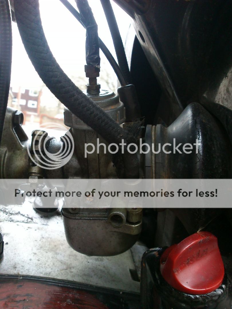

Well it's dirty and smelly. Only has choke and throttle cable. Inside it has a needle, it reminded me of the old mini su carb days. I was expecting the fuel bowl to be full of gunk but it was all surprisingly clean inside.
Now, if I bought a carb like the one linked above, would it be considered as an upgrade as in modern technology vs 20+ year old carb?
