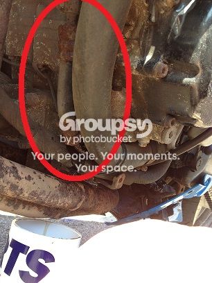

Still had my fingers crossed when I was removing the fairing that it'd be a dead washer or loose bolt.
No such luck, it was blatantly obvious as soon as I removed the fairing where the oil was coming from...
https://i755.photobucket.com/albums/xx191/Non-Adhesive/oilhoselarge.jpg
I've had a dig on Robinsons Foundry https://www.robinsonsfoundry.co.uk/content/pages/shop/parts/Suzuki/GSX-R/GSX-R600/V%20W%20X%20Y%201997-2000%20SRAD and a flick through the servicing manual couldn't see any engine diagrams which identify the part.
Found an old ebay ad (https://www.ebay.co.uk/itm/Suzuki-99-GSXR-600-SRAD-Engine-Oil-Hose-Feed-large-/121092675041) which identifies it as the Engine Oil Hose Feed Large.
Anyone have any idea's what the part number is?

It looks like the part number is 1128133E00.
Part 6 on the diagram at https://www.cmsnl.com/suzuki-gsx-r600-1998-w_model13566/partslist/FIG3.html#results

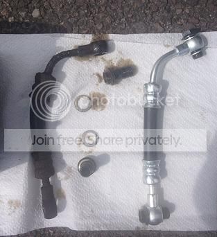

Old v New!
https://i755.photobucket.com/albums/xx191/Non-Adhesive/OldNew.jpg
New hose, 2 cylinder head union bolts & 4 gaskets plus delivery £99.97.
Having my SRAD back on the road... priceless! Very Happy

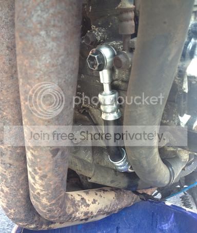

All fitted & torqued up to 25nm
https://i755.photobucket.com/albums/xx191/Non-Adhesive/photo5.jpg
Does make the rest of the engine/exhaust look shocking!
