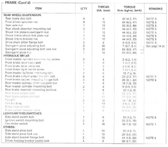

No. From memory the torque on that bolt should be around 27N m. The caliper isn't sliding freely on the pins because of corrosion or road crap. Loosening a fitting isn't the answer.
Aff
Joined: 05 May 2011
PostPosted: 20:28 - 27 May 2013    Post subject: Reply with quote
^ Yup 27Nm
https://i1135.photobucket.com/albums/m637/Biles/27-05-201321-26-30_zps332a593d.png
Whip the pin out and clean all the road crap/corrosion off, put a bit of silicone paste on and reinstall.
