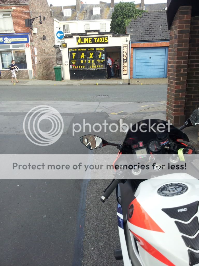

Power commander is just 2 plugs that fit between the ECU and main loom, just need to prop the back of the tank up to get to it.
I wired my volt meter into the power supply for the dash.
The one I use.
:edit: This gives you an idea of where I placed mine:
https://i1135.photobucket.com/albums/m637/Biles/20130827_171147_zps49dbf17e.jpg
