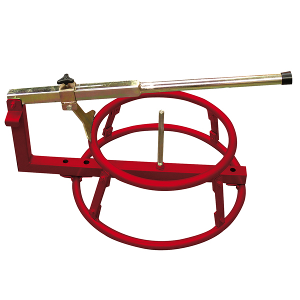

Has anyone ever had or used one of these? They are about £40 so not too expensive, just wondering if they do a decent/easy job of removing tyres? Cheers.

https://www.youtube.com/watch?v=93w0GynwnmU
They use something like that and it seems to work.

I'd probably buy one of those... I change a lot of tyres Laughing
Currently I'm using beta forums recommended method, blocks of wood and a spade. Works first time Laughing

I used to use a railway sleeper and my 18st mass to break the bead.
.....Till i bought a tyre machine that is!

I just use three G-clamps to break the bead, and three ratchet straps to fit the new tyre. Still pretty easy and quick, and I didn't have to shell out for yet more garage furniture.

I use a SDS drill, set to 'hammer only' action, with a wide chisel like the one below fitted.

Length of 4x4 timber, short wedge of 2 x 4 and a brick that juts out in my garage wall.
Never had an issue breaking a bead with it.

After seeing this product and watching a video, I am wondering whether I could just buy a large G clamp off eBay and use that? Looks like a simple way of breaking the bead to me.
Just re read this, guess G clamps do work. Smile what size g clamp do you use?
Whatever I've got laying around that'll go over the tyre.
