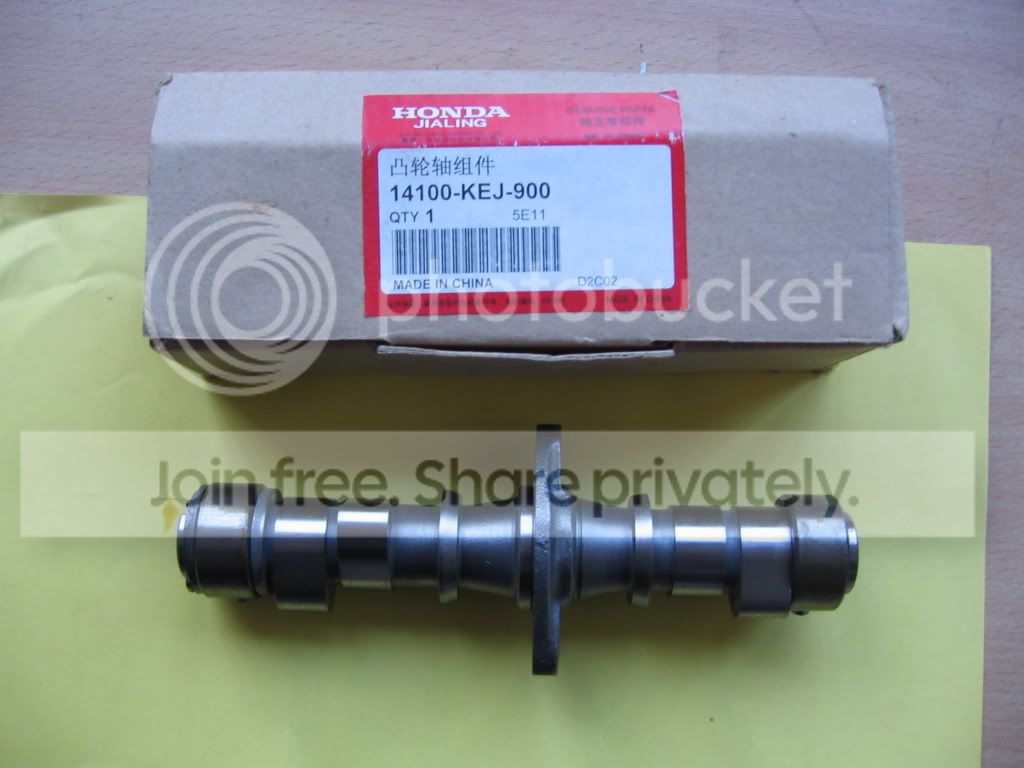

i found one on ebay can anyone shed any light
part number is 14100-KEJ-900
found here https://cgi.ebay.co.uk/ws/eBayISAPI.dll?ViewItem&item=140716231661
which model is this one for as they all seem compatable

Part Number not recognised on:- https://www.cmsnl.com/honda_model8286/
Dave Silvers Part Search throws up nada, & useful comment
the part may be a Japanese home market number.
Looking at the e-bay add:-
https://i631.photobucket.com/albums/uu31/sam-vtec/001-60.jpg
Honda 'Jailing'
Lobes look to be at 90 deg on the shaft so I think still for 180 crank motor; So probably be the same one that Riders are flogging; TD-J Spec.
They clocked one up for me & confirm its the same 'lift' as the 'Reduced-Effect' spec cam; so definitely NOT a 'Full-Power' cam, that is a 'high-lift' profile with an extra 0.5mm of cam lift... or about an extra 10%... cam lift is 5.5mm on the R-E cam, 6mm on the F-P.
So... £60 for that one (Coming from Hong-Kong)
Ryders are doing same thing, from inside UK, for £40 (https://www.ebay.co.uk/itm/390347193432?ssPageName=STRK:MEWAX:IT&_trksid=p3984.m1438.l2649#ht_1262wt_698)
