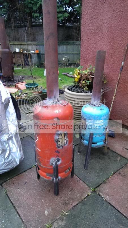

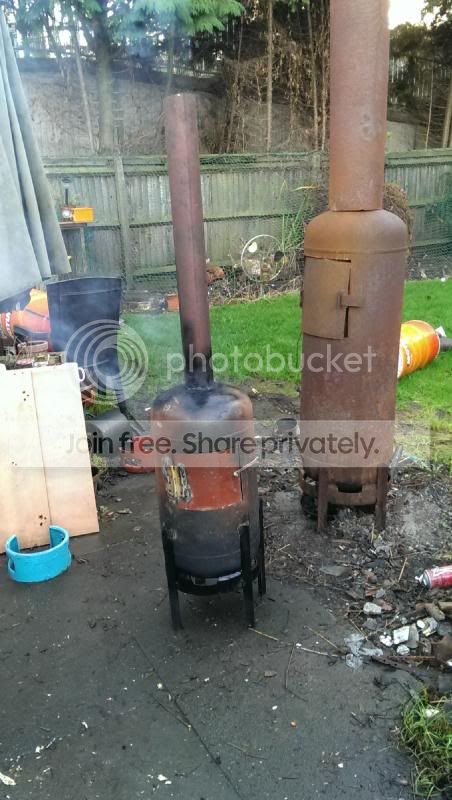

mr jamez wrote:
You can get home brew jobs made from calor gas bottles, very effective if they're made well. Available on ebay...
My husband makes them. Just finished 2 this weekend......... (the big one in the background of the second pic is his own, the 2 smaller ones are the new ones)
After grinding and welding finished but before final tweaking:
https://i12.photobucket.com/albums/a229/Yambabe/2013-12-20153718.jpg
Now with painted legs, added door handle, smoothed top and having a test-fire to burn off the original paint:

yambabe
PostPosted: 11:44 - 22 Dec 2013    Post subject: Reply with quote
With the right fuel they put out a lot of heat btw.
The big one is easily 10ft tall to the top of the chimney and even a relatively small amount of chipboard ( he usually gets old kitchen units out of skips) will see flames shooting out of the top and the whole thing glowing red.
I wouldn't recommend using one with an unlined flue!

yambabe wrote:
https://i12.photobucket.com/albums/a229/Yambabe/2013-12-21141417.jpg
Sorry to rain on your parade/Chimnea. Very Happy
But they look well unstable and easy to knock over.
Full of fire they'd be a hoot as they topple. Razz
Can I suggest the legs are made much wider at the base.
Not being a Safety Nazi but only a concerned voice. Karma
They do look unstable, but we have never had one go over in the 10-ish years he has been making them for now....... Thumbs Up
