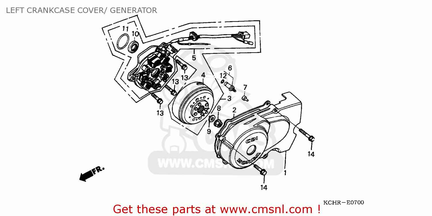

I'd like to take off the left crank case cover. Can I do so without any oil pissing out? I also noticed a gasket as well. Anything I need to watch out for?
Reason being I need to remove this cover inorder to access my engine-to-frame bolts to tighten top one and replace the lower one as its snapped.

There's no oil behind the left hand cover

yes and watch out for the neutral sw coming out...........is part number 7 the insulated plastic spacer to keep the neutral sw in when the cover is on............green/red wire......

Yeah like the guy above said, it is a crushable(not sure on the technical term) gasket, so once crushed in place, it should be changed for a new one.
