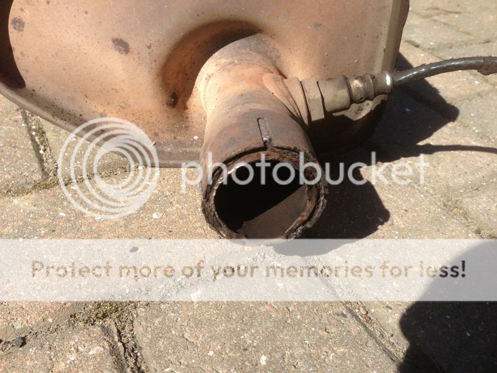

Common fault, snaps at the weld at the end of the down pipe. As the pipe flexes it finally fractures. Just hope and pray the studs come out.
This was my exhaust after it snapped, the last section of the down pipe is still inside the back box.

Yup, that's exactly the problem, it probably didn't help that the clip had rotted away to nothing, too. How much of a twat was it to get that bit of header out of the box? I've been knocking shit out of it for 20 minutes, and it's just laughing at me, i'll just have to get hold of a cutter of some-sort, and cut it from the inside.

How much of a twat was it to get that bit of header out of the box? I've been knocking shit out of it for 20 minutes, and it's just laughing at me, i'll just have to get hold of a cutter of some-sort, and cut it from the inside.Either that, or new end can as well!
Easy actually. Dremel straight down the slots on both sides which relieves the pressure then you can just get a screwdriver under and pull out. There is the 'gasket' around the pipe so it does move, you just need to relieve the pressure and you can pull it out.
