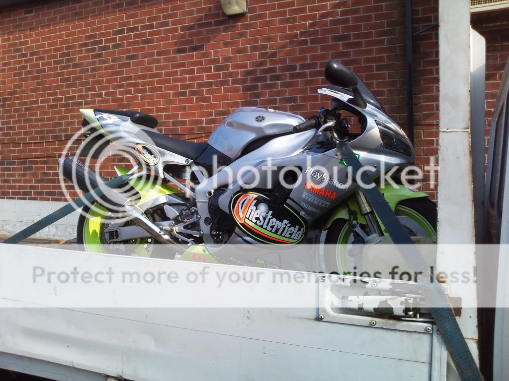

For my old R1, i stuck it on the back of a flat bed van and used two or three ratchet straps.
The straps had hooks on which i didnt use. I wrapped the strap around the fork or forks (cant remember if i had one on each side of the front or not) and used the hook to hook on to the strap.
For the rear i used one strap going through the rear pegs.
No need to remove fairings and it didnt budge from Scotland to Essex.
Getting it on and off the 4ft high back was a whole different matter....

Turns out i had 2 on the front.
Found a picture:
https://i256.photobucket.com/albums/hh163/adam673673/Photo0029.jpg

The thing is with my collapsible trailer is that the front hooks are parallel to the handle bar so if i was using front fork it was going to scrub against the middle section of fairing.
I don't have the handle bar straps otherwise could have used that.
I send a pic next time it is strapped it so you can see if I was to wrap it around fork or handle bar then i would have damaged the fairing
I just took the middle fairing off. It took me 10 minutes for both side and then i had a piece of mind

pic of my bike on the trailer so you can see what I mean when I say I had to take the fairing off
https://i57.tinypic.com/dyx2fd.jpg
https://i57.tinypic.com/5vb0ac.jpg
https://i61.tinypic.com/2eohdub.jpg
