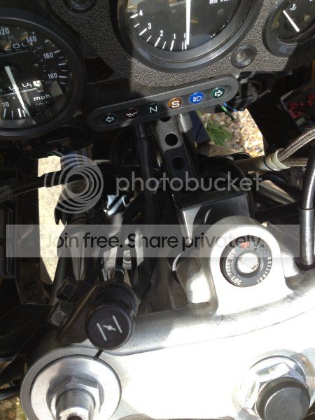

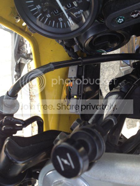

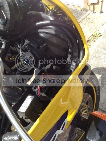

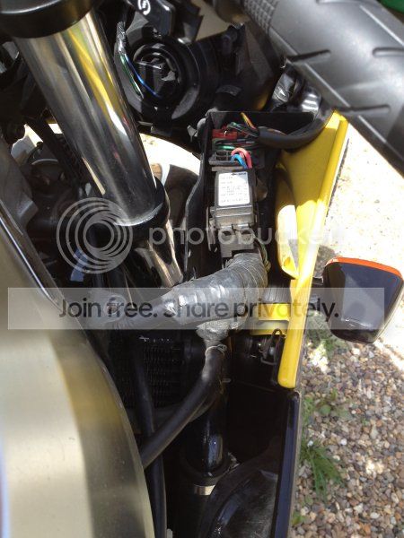

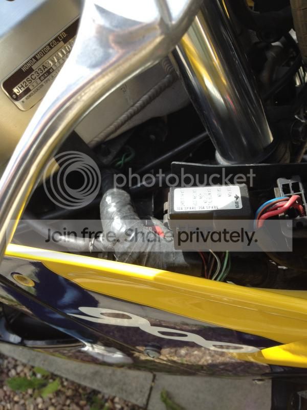

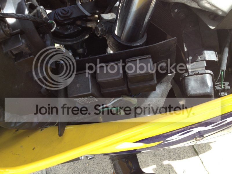

Here you go, took these just now of my RRV. Hope it helps.
It looks like you are missing some plastic panels that the fuse box and relays get secured to.
https://i83.photobucket.com/albums/j303/330paul/rrv-wire/wire1_zpsa9264214.jpg
https://i83.photobucket.com/albums/j303/330paul/rrv-wire/wire2_zps0f787729.jpg
https://i83.photobucket.com/albums/j303/330paul/rrv-wire/wire3_zps15407c71.jpg
https://i83.photobucket.com/albums/j303/330paul/rrv-wire/wire6_zps293de3f7.jpg
https://i83.photobucket.com/albums/j303/330paul/rrv-wire/wire4_zpsa3002015.jpg
https://i83.photobucket.com/albums/j303/330paul/rrv-wire/wire5_zps942703de.jpg
