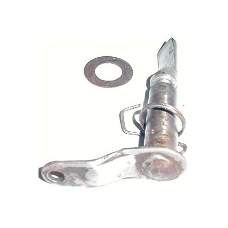

You see the bit that the cable "sits in" the kinda metal looking sleeve, not the nipple but the actual cable.
That part of the cable is threaded for a reason. You have one nut either side of that, you then adjust the clutch cable by unscrewing the nuts, adjusting it and tightening back up.
The bit coming out of the engine should have something like this on it...
https://s3.amazonaws.com/thmb.inkfrog.com/pix/independentcycle/CLUTCH_LEVER_(2)_026.JPG/450/1
You should have a clip inside holding that part in. Initially I was looking at the clutch cable itself... Laughing
