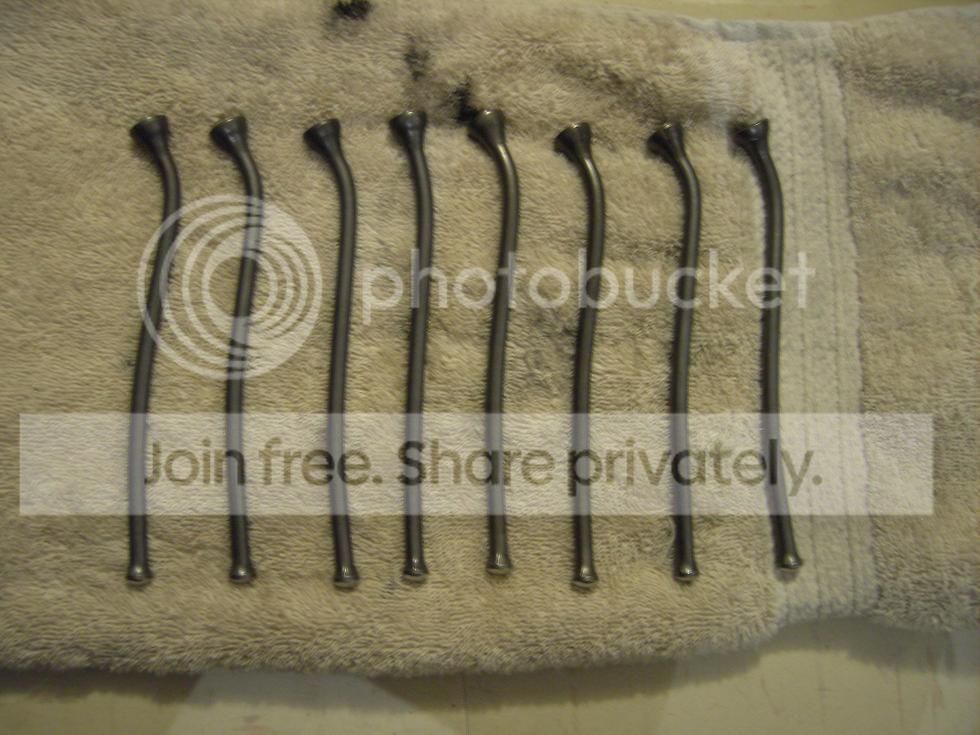

See if anyone can:
1. Identify the parts.
2. Identify what is wrong with the parts.
3. Identify what caused the problem.
Car is a '98 Discovery 300tdi.
First to get all 3 gets Thumbs Up

push rods
bent
cam belt

Marmalade 3 for 3.
That was quicker than I thought Laughing

got two was thinking somthing else caused it Laughing
PostPosted: 19:29 - 30 Jan 2014    Post subject: Reply with quote
1) Coat hooks.
2) Supposed to be push rods.
3) Car is a '98 Discovery 300tdi.

How are the valves and pistons?
They are inside the engine.....
Probably fine though - they usually are on these engines when the cambelt goes. But, 'usually' only a couple of pushrods get bent.

How many miles on the engine?i'm booked in for my defender a week on monday for a cambelt, i'm on 136000.

141k and a bit...
I have yet to decide whether I can be bothered to fix it.
