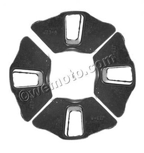

BUT get a set of these:-
https://i.ebayimg.com/00/s/NDEyWDM4OQ==/z/LgsAAOSwQItT8cvX/$_35.JPG
As matter of course. £9 off Wemoto e-bay, they are the rubber blocks that go in the cush-drive. Its a five minute job to swap them, no special tools necessary, and they make a WORLD of difference to the bike. They are almost always hammered to death putting slop in the drive line, which is over-looked, neglected or not kown about. BUT, new ones an transform the way the bike rides, make gear changes a heck of a lot easier & smoother, while givig your drive chain a much easier time, so it doesn't wear out as quick.
