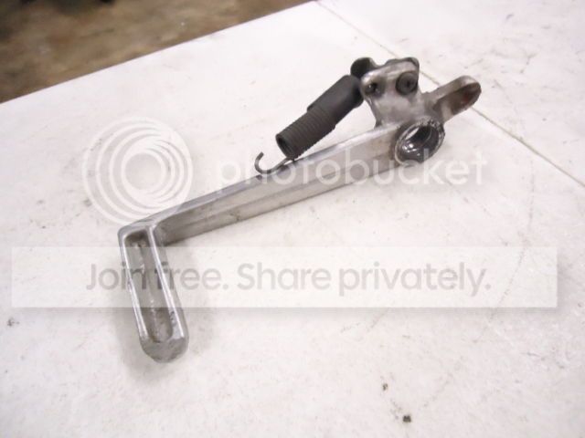

I bought a TIG welder about a month ago and been practicing with it never having done any before. One job I've been putting off was welding the end back on my brake pedal because I was told that cast was more tricky to weld than sheet. It was snapped off a while ago and for a year or to I've had a clutch spring post as a pedal end.
So I cleaned it all up and filed the ends flat, clamped it in place on my bench, tacked it on, checked the alignment. Took the plunge and welded it all up. Not so bad I thought and I stood back to admire my handywork......

Yeah, keep above 2mm thickness for practice. I find ally easier than stainless, I keep touching down the tungsten on stainless a lot and I find it less forgiving than ally if you get the current wrong. One thing I am getting over is trying to weld with too little amps. You worry that it'll blow holes but in reality all you have to do is move faster.
Pedal is fitted now BTW. After my initial moment of pique I just cut it off an dlfipped it over.
