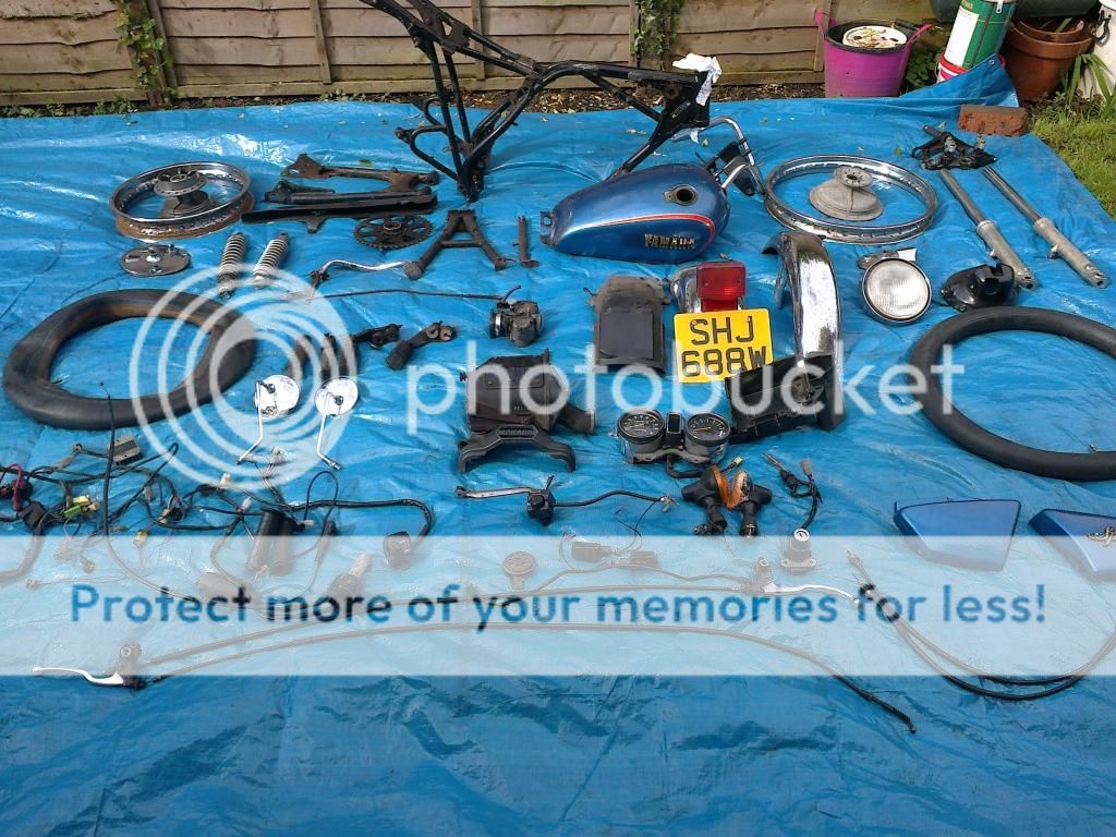

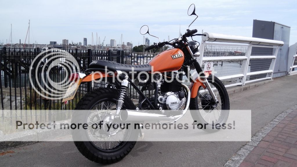

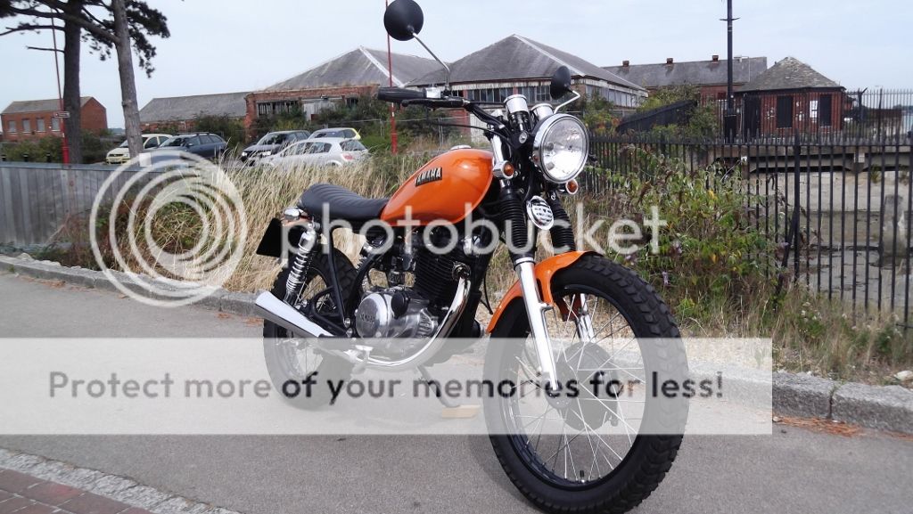

Hi people,

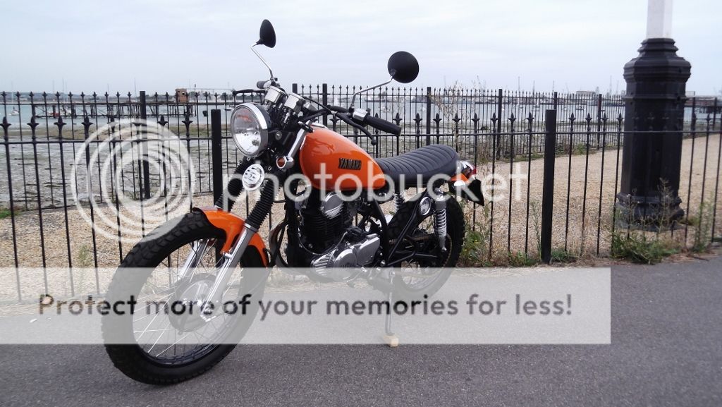

I'm new to the forum and thought I'd better start with showing you my bike. I bought it in very poor condition last June and have spent the last year on and off rebuilding her. She's a 1980 Yamaha SR250 and I've styled the colour scheme after the Ford Escort Mexico. Hope you like:

Cheers Matt, well to start with there was the strip down, a lot of these bits were crud and didn't make it back onto the bike, including the swingarm that a had rusted through. The frame was de-tagged (with my trusty grinder) of all the bits I no longer wanted and sent for powder coating along with a new swingarm (second hand from ebay), wheel rims and hubs. Here she is in kit form:

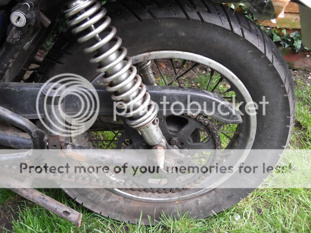

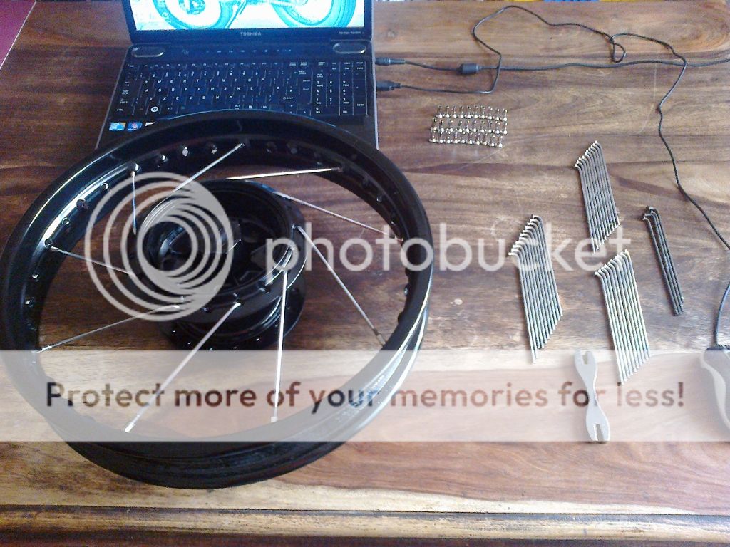

Onto the wheels. The tyres were perished and the rims and spokes were very rusty:
https://i623.photobucket.com/albums/tt313/SteveGreen123/080720125381024x768-1.jpg

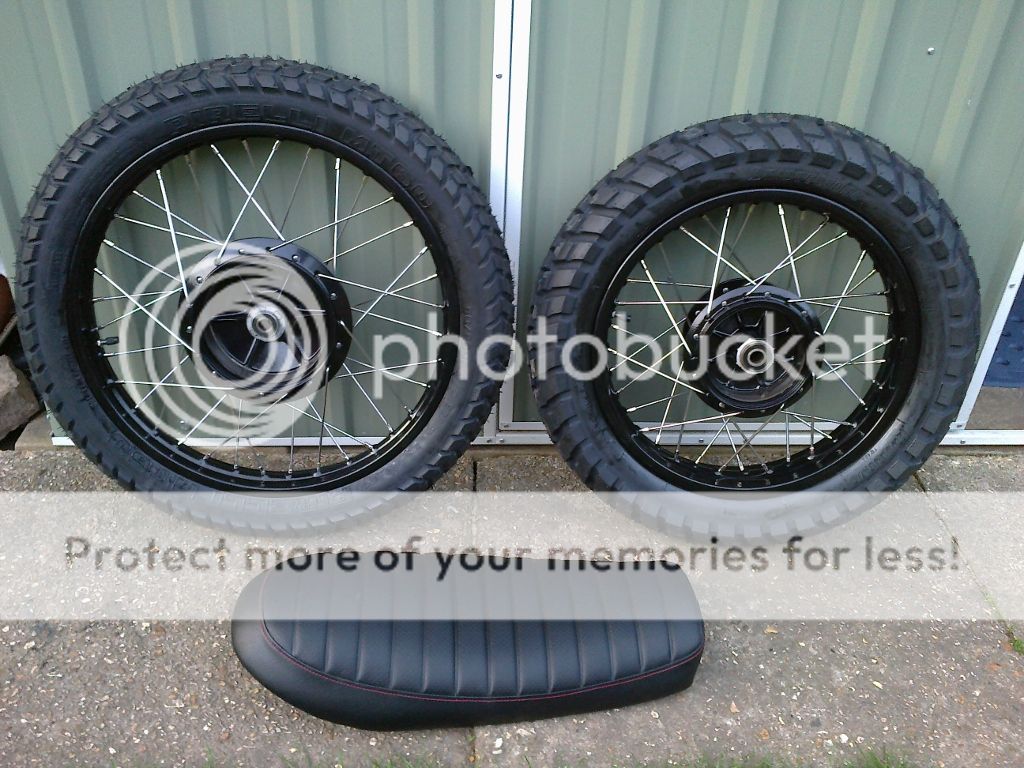

The rims and hubs were powder coated gloss black and I had two sets of stainless spokes made up with new nipples. Each wheel had four different spoke sizes. Shocked I laced the wheels myself, it took a while to get the hang of it, but I would recommend anyone to try it for themselves.
https://i623.photobucket.com/albums/tt313/SteveGreen123/260720125671024x768-1.jpg

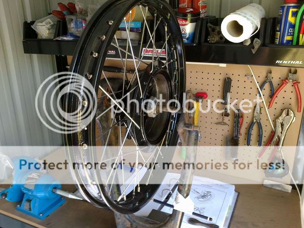

Once laced, I trued up the wheels using the old swingarm, a vice, a pencil and a bit of tape:
https://i623.photobucket.com/albums/tt313/SteveGreen123/290720125731024x768.jpg
And here they are finished with their new shoes on:
https://i623.photobucket.com/albums/tt313/SteveGreen123/310720125791024x768.jpg

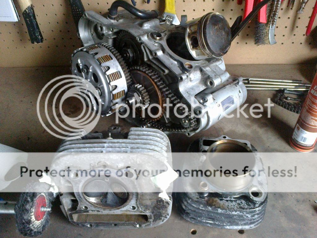

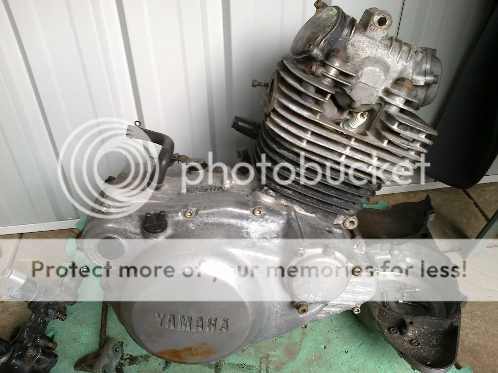

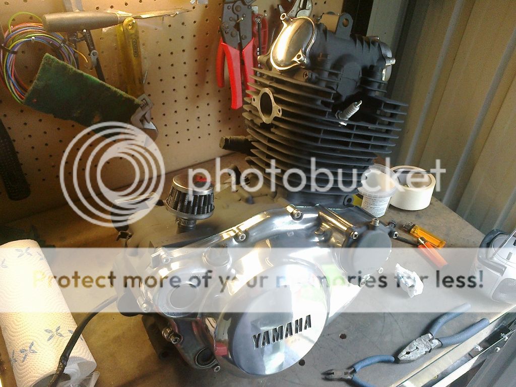

The engine was a runner, but in a bit of a state. Mostly from very leaky tappet covers and age (32 years, 27,00 miles).
https://i623.photobucket.com/albums/tt313/SteveGreen123/080720125311024x768-1.jpg

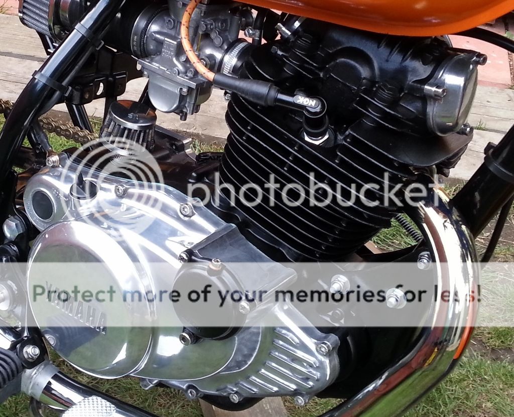

I ordered a full engine gasket and seal kit and stripped it down. Internally the engine was in good condition, so I just gave it a good clean, lapped the valves and re-assembled with the new seals and gaskets. Oh and a new stainless Allan bolt kit.
https://i623.photobucket.com/albums/tt313/SteveGreen123/051020127851024x768.jpg

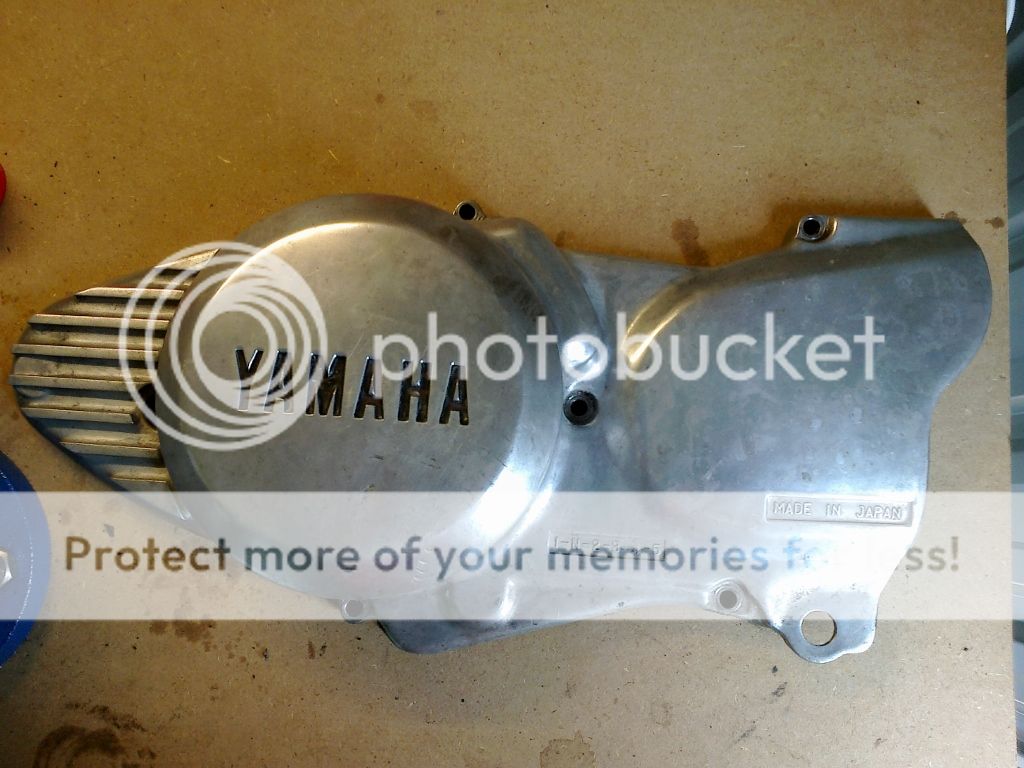

I polished up the side cases and covers and sprayed the rest black in matt black High temp paint:
https://i623.photobucket.com/albums/tt313/SteveGreen123/100720125431024x768.jpg
https://i623.photobucket.com/albums/tt313/SteveGreen123/100720125441024x768.jpg
https://i623.photobucket.com/albums/tt313/SteveGreen123/131020128381024x768.jpg
In the end I didn't like the paint, so I repainted it with satin black high temp enamel.

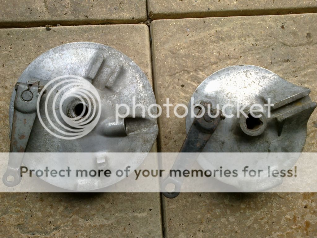

The next job was to get the wheels on. New bearings were installed. The drum brake plates were polished up, new brake shoes installed, and the brake actuating arm was stripped, primed and sprayed gloss black. I also managed to find new castle nuts and stainless split pins for the axles.
The rear sprocket was replaced and new locking tabs fitted. I also managed to find a NOS centre stand on ebay, but it will not be on the finished bike, just the build.
And we have a roller Very Happy :
