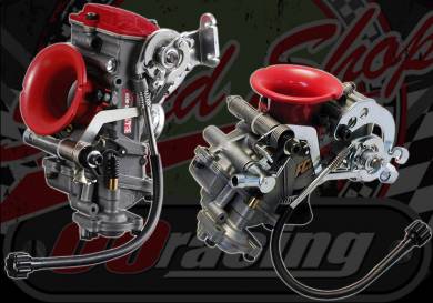

Bellmouths, Velocity Stacks, Trumpets, Ram Horns whatever you want to call them...these thingys;
https://www.motorcycle-exhausts.co.uk/admin/images/CR%20Alloy%20Stacks.jpg
Sits on the carb like this;
https://www.ooracing.com/store/images/source/Carbs/FCR-28.jpg
Needs to be of clamp on/bolt on fitment and have an ID of 55mm.
I can't seem to find anything suitable - any suggestions? Confused

Baotian BT49QT-20C.
However, the only standard bits of the motor are the crankcases - the carb is a Stage 6 version of a 30mm Keihin PWK flatslide.
Would ideally like it to be around 50-70mm long. Not going for a performance gain, I simply plan to run no filter & this moves the air intake out of the path of all the crap getting flung off the back wheel. Also makes the carb throat easily chokeable by hand as the carb has a non cable operated choke that isn't very easily acessable.

Unfourtunately the ones linked are suitable for the two bolt Dellorto/Weber style carbs rather than the grub screw bolt on style I'd need - My carb doesn't have the two mounting points.
https://www.feked.com/images/detailed/0/fkbell422-1-600.jpg
OOracing seem to go up to 50mm, but I cant seem to find anyone making anything that'll fit the monster carb Laughing
