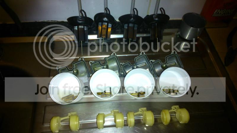

First time I done the carbs it was while I was at college and I had 2 1/2 hours to strip the bike, clean them and rebuild everything. I found that the idle jets were blocked. They were cleared and I had pretty much run out of time and had to rebuild the bike again.
Second time, I was working in my lock-up and I got the carbs off, check the diaphragms etc then the weather got the better of me.
Third time, I decided to get another can of carb cleaner, got the carbs off and at the risk of getting in to trouble from the concierge, brought them up to the flat.
They were stripped to this point:
https://img.photobucket.com/albums/v320/andy36586/DSC_0391_zpsazjkvblq.jpg
A full can of carb cleaner was used and this time I made sure I sprayed all the holes, gaps, nooks and crannies.... unfortunately I didn't have any compressed air to blow through everything to check it was all clear.

1. The carbs weren't separated, as I've only done it once and even then it wasn't necessary... idle is fine, low speed is fine, runs exactly the same cold or warm.
2. I've had the carbs out of: 50cc scooter (I know it's only a silly little 1), 125 intruder (same again), GPz 750 (2 days to refit them, and even then it was brute force and ignorance that was used, and the bike ran fine afterwards), zxr 750 h1 (which the carbs had been stripped down and rebuilt several times, and I will admit that because they had been rebuilt from 2 sets the bike never played fair), and the CBR.
3. This one I will check tomorrow.... but again wouldn't this affect the engine at high revs rather than affect speed?
4. See above
5. The bike had this problem since I bought it, last week I got the extensions and rubber pipes to make extensions to make balancing easier. OK it was only screws and washers that were in there previously, the new fittings had rubber O-rings and were thread-locked in to place..... maybe it was the balancing the carbs (finally), but now the bike is easier to start, will quickly get to 3k rpm with the choke in the morning, responds instantly to twisting the throttle on the motorway, slightly more power etc
