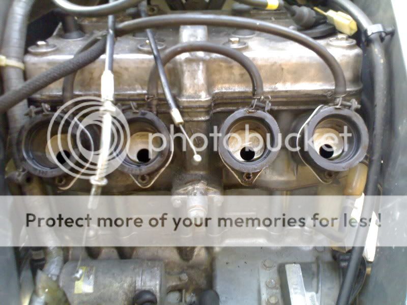

Tank off, then air box off.
Remove the carb / throttle body from the rubbers ( leave the rubbers on the engine)
You should see big washers similar to these
https://i14.photobucket.com/albums/a324/david_m213/zzrrestriction.jpg
Yank em out.......
Not literally you'll damage the rubbers, probably have to undo the rubbers from engine and take them out of then put rubbers back
After having a good google at new kits for the 07 hornet - i do not believe the jetting is changed when fitted so that should be job done.
Carb back, air box back on, tank back on - new undies first time you forget and "launch" off the lights Wink

Those washer aren't throttle stops. Laughing
The throttle stop that was on my 33bhp TL1000R was a part that was changed so the original part was needed for derestricting it.
Do you know if it's an FI International kit or something else? If it's FI International then you might be able to find the fitting instructions somewhere online. The place I got mine fitted gave me the standard part back and the fitting instructions.

OP thinks it's a throttle stop restriction, not constrictor washers.

I read it as "plates inside the throttle body", so thought he meant restriction washers Embarassed
