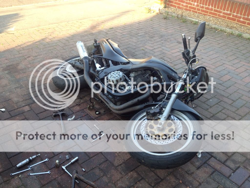

This is how I did mine...
https://i789.photobucket.com/albums/yy178/AzAndBikes/Mobile%20Uploads/2015-02/1FDEAF36-34F0-41B7-AEF1-37B095A4DCC9_zpskxtesxvz.jpg
Does that not affect the carb or fuel system laying it like that?

PostPosted: 09:04 - 31 Mar 2015    Post subject: Reply with quote
Personally I would switch the fuel tap to off before doing it that way. I would also invest in an Abba stand too before doing it that way.

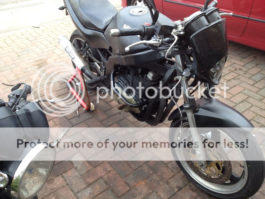

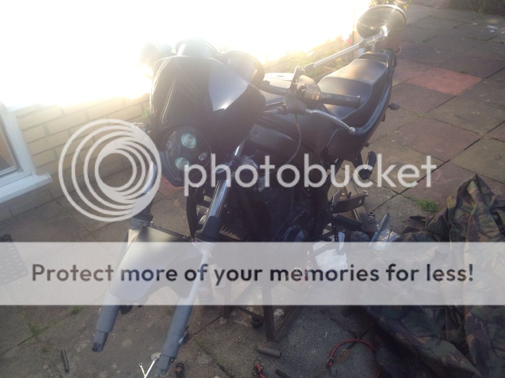

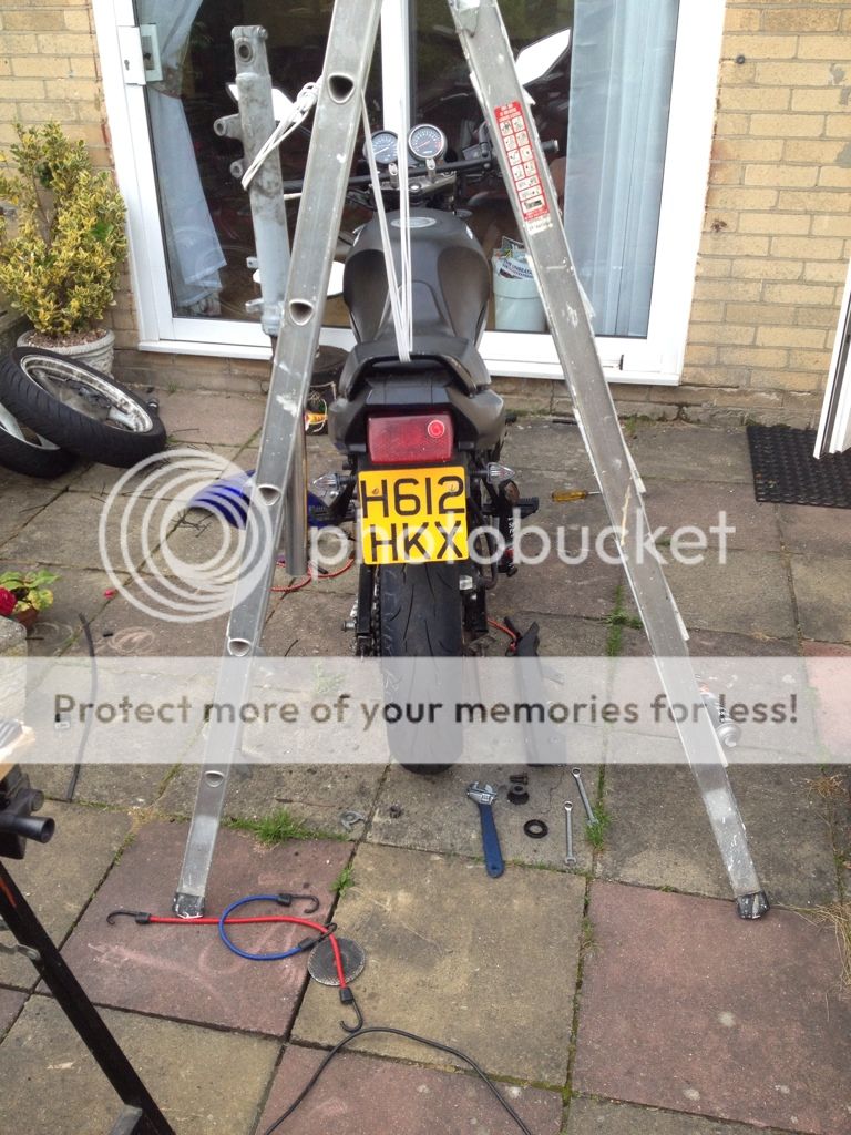

PostPosted: 15:12 - 31 Mar 2015    Post subject: Reply with quote
Get creative when you need to get a wheel off the ground for maintinance work.
Step ladder and a washing line, jammed in place with bent fork leg.
https://i1148.photobucket.com/albums/o574/_Iain_/07264643.jpg
Car ramp;
https://i1148.photobucket.com/albums/o574/_Iain_/50143ede.jpg
Bricks/sidestand combo;
https://i1148.photobucket.com/albums/o574/_Iain_/6A8A61D3-C7A6-4D55-8945-80EC9E718F8A-156-00000006D96B8FB9_zpsa8e06d64.jpg
Borrowed paddock stand;
https://i1148.photobucket.com/albums/o574/_Iain_/D9E2020F-BC52-44F1-A6A9-034A76D1CDA1-2184-0000035E34675203.jpg
Kick it over;
https://i1148.photobucket.com/albums/o574/_Iain_/5394E4A0-4572-4883-830C-66B2100F5569-94-0000000442086A10.jpg
You get the idea.
I don't have a pic, but a trolley jack under one side of the engine cases making the bike balance at a 45 degree angle on the sidestand is a really good way of doing a shock.

Az
Joined: 16 Apr 2013
PostPosted: 22:35 - 31 Mar 2015    Post subject: Reply with quote
rk8479 wrote:
It started and ran perfectly fine after, so I'm assuming it's okay based on my experience... Maybe I got lucky?
