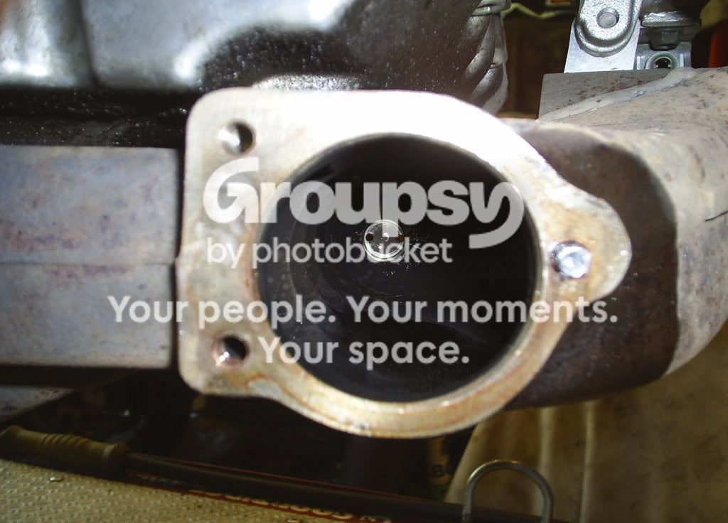

When I serviced the valve on my R1 there was a plate on the far side of the vane housing which could be removed so as to drift out the worn bush
https://i666.photobucket.com/albums/vv23/WiNot_Rhencullen/Workshop/20100425_3-1.jpg
On my Exup1000 the hole is blind so is almost impossible to remove that bush.I ended up drilling a hole and using a blanking screw to seal it after I had replaced the bush Thumbs Up

EDIT: looking at your photo, i think the bush came out on the valve, Is that photo with the bush removed?
