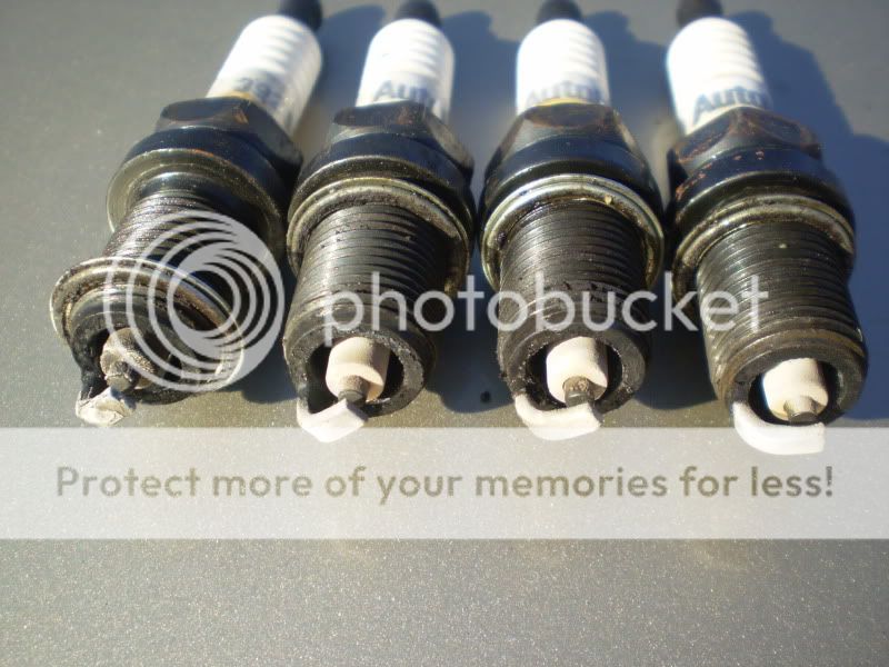

I've bought a CG125, and the spark plug looks exactly like this......white core, very white tip.
From what I deduce, that's running lean? Any suggestions on where to start?

Air filter plugged.
Jet in carb plugged (normally with a crusty stuff) or a simple bit of shite.
Fuel flow from tank to carb blocked. Tap, Hose, in-line filter if fitted.

Air filter looks brand new. Some mayonnaise collected in the bottom of the housing, I assume from the breather.
Is it easy to get to the carb to clean/check it? I've got some Seafoam I could run through her too
Couldn't be easier, it's right there between the engine and the airbox.
Google assures me that this is a CG125 carb:
https://www.pakwheels.com/forums/attachments/honda-bikes/1253935d1377680744-cg-125-euro-ii-2013-problem-murree-carb.jpg
It's not, it's a picture of the actual carb on my old HN125-8 copybike which has been blagged and tagged by Pakistanis. Actual FACT. Should be close enough though.
If you're spending a lot of time idling then you can try adjusting the mixture screw. Back it out to richen the mixture. However, if that's the result of running under throttle then I'd suspect the main jet, needle, and/or float height
Also, what's the heat rating on the plug? NGK D8EA would be typical. Has someone been trying to get clever?

It's an 8 but I've ordered a 9 as per this chaps recommendations...
https://hondacg125.awardspace.com/spark_plug.htm
"You need a NGK DPR8EA-9 spark plug for normal riding and a NGK DPR9EA-9 for extended high speed riding,
The extended high speed riding spark plug is stated in the Honda CG125 Front Disc brake models Owner's Manual"
"I found that 54mph in 5th gear is high speed for the plug and results in power dropping off if left at that speed for 1/2 mile.
The power drop off (plug overheating), results in the bike dropping to 50mph against a very strong head wind,
if you slow down a lot the plug will recover.
I fitted the DPR9EA-9 plug and end of problem = no power drop off and the bikes about 5 mph faster"
I definitely found this on the 1hr jaunt back from Oxford. The throttle was pinned open almost the entire way home. The M40 made a man out of me Laughing

Yup, I fitted a 9 to my HN when I took it on a tour. Worth a try.

https://i134.photobucket.com/albums/q98/pimpin88_photos/Saturn%20white%20spark%20plugs/P7150027.jpg
Those plugs. What make are they anyway? Don't look like any of the common brands. Compression washers look shonky as hell.
It also sems to me that they still have the screw-on adapter on the top suggesting you have a non-standard plug cap fitted.
Tuning by sparkplug. I fitted BP7HS plugs to my Bullet instead of B7HS because more compression innit?*
* This may cause the piston to hit the sparkplug in some engines.

That was the closest pic I could find on Googly. It's not my plug or plugs. No plug comparison chart had anything near as white so I scanned ze net

My 07 CG had plugs that were almost grey/white, they were supposed to be that way as Honda made the CG very lean to pass the euro 3?, I think it was that one. Anyway I had no problems in the 15k or so I did.
Mark
Aha. Mine's a last of the line 08'
