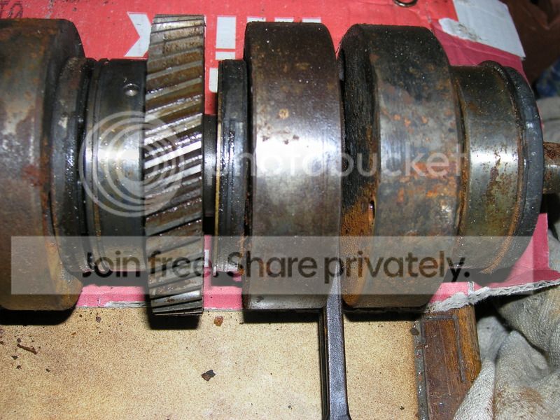

interesting...what 2t engine are these for, staggered transfer ports......a side exhaust port??
https://i77.photobucket.com/albums/j71/Drewskovitch/Jap%2070s%20bike%20toys/Bike%20toys/M%20Engine%2014_zpsgmapudos.jpg
is this the engines crank??
