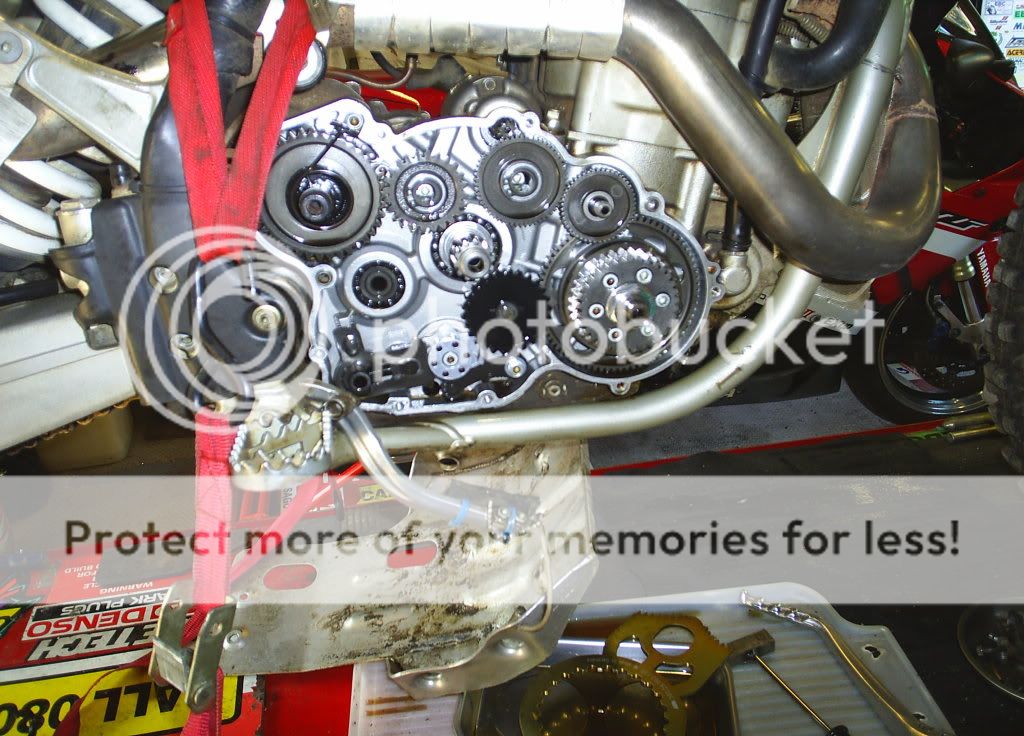

I used a 2p piece when doing the KTM
https://i666.photobucket.com/albums/vv23/WiNot_Rhencullen/Workshop/Picture006.jpg
Always have a 'Plan B'
