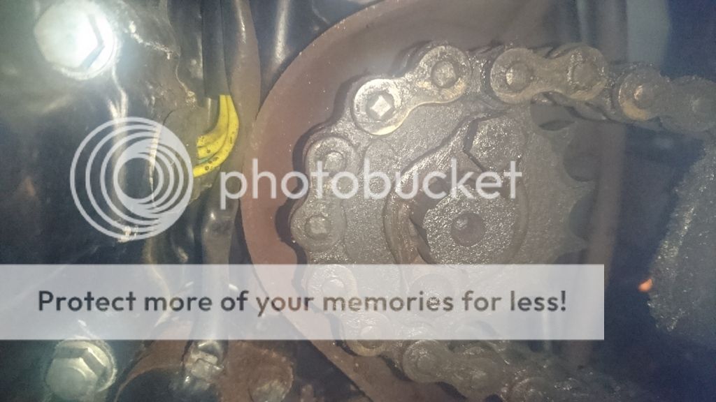

HI all.
So, went to remove front sprocket on my daelim vjf125. the fixing plate, instead of having two bolts, has one bolt, and some sort of security tab. It seems to have no way of removing without drillling out, as i asumme its threaded in the same way as the other bolt is.
Anyone p[lease shed some light on how to get the bugger out??
i know that the chain has tight spots btw, and its filthy!!! im waiting to get the sprocket off to replace both sprockets and chain together.
heres a link to a pic too, as i suck at attaching photos lol!!
Thanks all, in advance.
https://s1123.photobucket.com/user/vladthetodge/media/Mobile%20Uploads/DSC_0239.jpg.html?o=0
Pete.

Doesn't seem useful, or even likely. How would they fit the pin then install the retainer? Try removing the one bolt and see if the retainer will turn to align the splines.

Tried that. It won't budge. The security bolt goes through the retainer. Was actually thinking of using a bolt remover bit on a drill and trying to get it out that way after a little heat application.

I'd assume that's a shear-bolt. You might have luck getting an Irwin bolt grip to bite on it.
Failing that, weld a nut on it?
A local garage would likely have it off in seconds.

Just a shear bolt, innit?

Shear...
Tighten it up, the hex head snaps off leaving a rounded dome. It's likely just a regular bolt rather than a pin under the remaining head though; if you can get a grip on it it should rotate out.
Looks like the idea is simply to stop Joe Owner from changing the sprocket. I believe that Korea has or had some legislation about not tampering with the power train. The Hyosung I had a go at had adamantite rivets holding the end can on, I dulled several unobtanium bits drilling them out.
Look forward to similar anti-tamper insanity on A1 and A2 bikes sold in Europe from next year, although I don't know what details (if any) were settled on.

hi,
seen plenty of these security/shear bolts on ignition barrels before but never on a front sprocket....
easy enough to remove diy though.
cut a slot in the domed head with a hacksaw or preferably a dremel.
a nice deep clean slot helps Smile
then just use an impact driver or large screwdriver to undo the nasty "bolt".
then take it outside & kill it with fire, then bury it in concrete at the bottom of your garden Smile
& then replace it with a standard bolt.

Can you take a picture of this bolt?
PostPosted: 20:32 - 23 Nov 2015    Post subject: Reply with quote
https://i1123.photobucket.com/albums/l542/vladthetodge/Mobile%20Uploads/DSC_0239.jpg
A sheared shear bolt then a standard bolt by the look of it.
Or a mangled dome headed allen bolt?

certainly a shear bolt.

It is indeed a shear bolt, some Korean/chinese takeaway bikes have them fitted for the reasons Roger stated, I encountered one a couple of years ago.
We ground a couple of flats on it and wound it out with mole grips. Do it before you remove the chain, make life easier.

Does look like a shear bolt.
One step back from a welded sprocket.

I wouldn't. Grinding the head off will leave you with a stub still bolted into the sprocket and flush with the retainer that'll still stop it rotating and coming off the spline.
What Gaz / Fisty said / Irwins / grips / weld a nut on / (reverse) drill and use a big bolt extractor / take it down to the local independent - they might take it out in return for the laugh it'll give them. Wink

The bikes I've had with two bolts holding the front sprockets on have always been very very easy to undo (unlike the single bolt variety which have sometimes been bastards).
Might be worth just trying the punch and hammer trick in an undoing direction before breaking out the heavy tools. Put the bike in gear and get someone to put pressure on the sprocket to take out any play in the transmission first.
