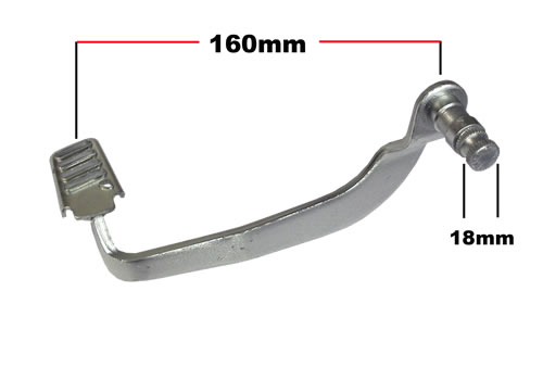

Yup, it's splined, here's a better picture.
https://images.wemoto.com/full/LEVER_BRAKE_HONDA/10021003.jpg
OK, easy peasy then, bolt 21 will be sitting in the groove between the splined parts and holding the pedal in place. Remove that bolt and the pedal will pull straight out, rotate it to where you want it, push it back in and replace the bolt. No need to touch the adjustment at the rear, although you may want to check it while you're at it.

So, first chance I've had to have a good look. I've removed the pedal and had a look. The reason the pedal was too high seems to be the piece of metal under the footpeg, that stops the pedal rising was bent very high. I've bent this down and seems to have solved the problem. Am trying to put the pedal back in, but think I might have bent the spline a bit, it won't properly go in Sad Have had enough for today, will look at it tomorrow. I can get the pedal inbetween the two splined bits, but can't knock it entirely in. Extremely frustrating
