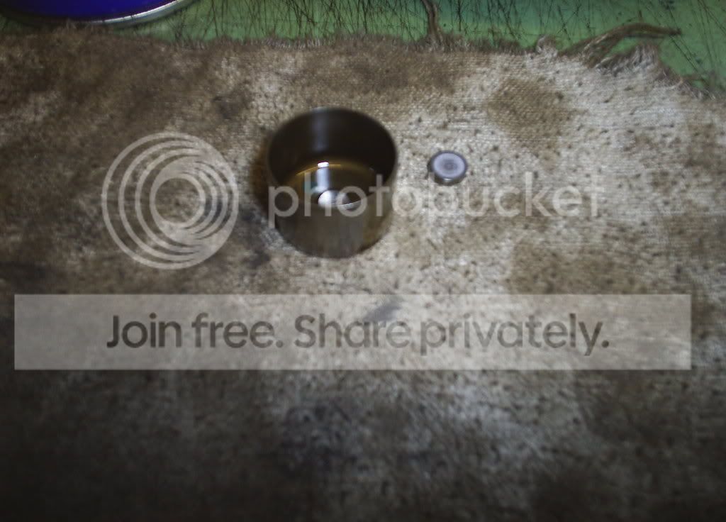

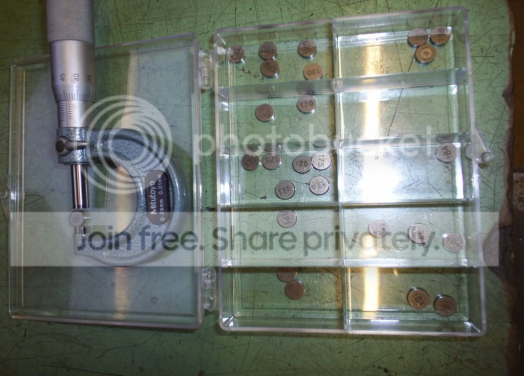

If the shim is 'under bucket' and needs replacing because the clearance is too tight,then the cam would need displacing in order to remove the bucket and shim,like on this R1 engine
https://i666.photobucket.com/albums/vv23/WiNot_Rhencullen/Workshop/Picture366.jpg
https://i666.photobucket.com/albums/vv23/WiNot_Rhencullen/Workshop/Picture360.jpg
Then,if the shims cannot be swapped around,then replacements would need to be sourced
https://i666.photobucket.com/albums/vv23/WiNot_Rhencullen/Workshop/Picture358.jpg
If I did not have a stock of the common sizes for the Exup and R1 then I would buy them from Wemoto,who sell them at a reasonable price.Genuine shims are not cheap Confused
Just to get to measure the clearances takes quite a bit of time,which is all chargeable.So every minute removing the tank/seat/fairing panels/airbox/coils etc soon adds up Shocked
